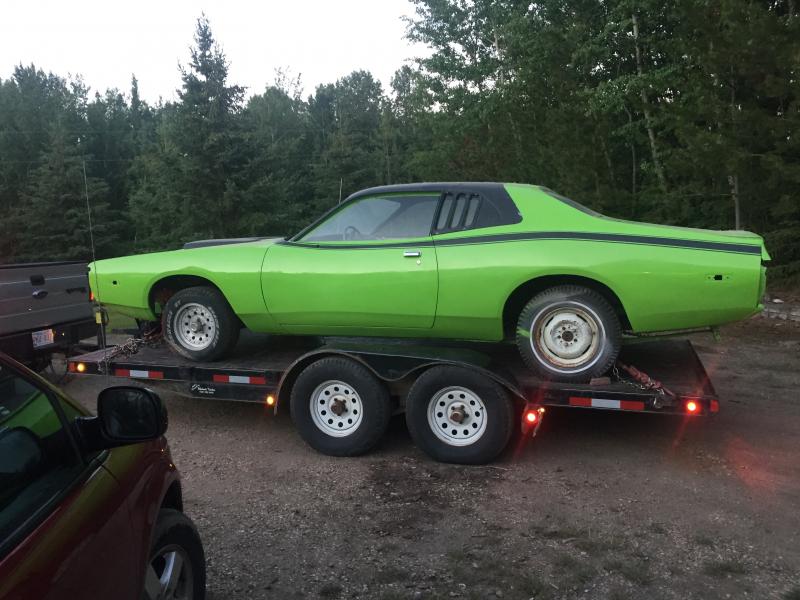

hey im from Edmonton alberta redoing up a 73 charger se that original was a 318 that now i have a built 440 going into it, hope to have it movable before snow, and perfected before spring!

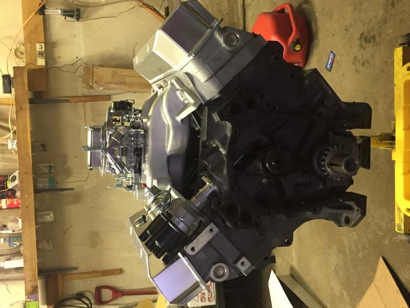

Here is my beast. Running a 440 built with a set of 440 source aluminum heads, quick fuel 850 carb, Chrysler dizzy with orange block, 285/297 545 valve lift cam, 10.5 compression, 3k stall and built 727 trans
