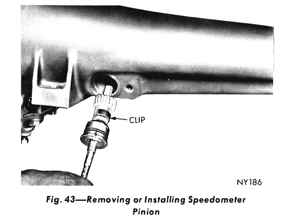

Thanks for the add! Hope it's okay to ask a question at this point. I need some advice please. Recently picked up a 65 Belvedere II 318 poly automatic. Well it wasn't long before it started leaking a good amount of tranny fluid on my garage floor from the speedometer cable. I ordered a speedometer cable housing seal set but when looking at the area, I'm wondering if the transmission cross member has to come out to get to it? The cable just has the one 1/2" bolt with the little fork but it seems very hard to get at. Thank you all
Welcome from Southern California. Never worked on a 1965, but I'd guess it's very similar to late 60's vehicles. Just jack the car up, put it on stands and give yourself enough elbow room to work around the exhaust pipes. You can do it Hardball. I prefer to remove as few parts as possible.

Welcome from Alabama, looks like @moparedtn showed you the picture from the service manual. Looking at that, I believe it can be serviced without removing the cross member.
