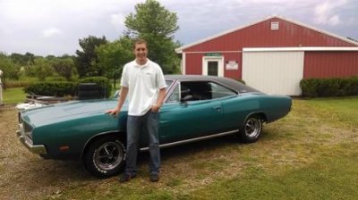

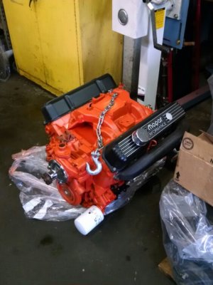

pics of me and my car, and the 440 just after it was finished rebuilt and painted!
Stegs. What size chambers are in the heads you now have, what casting number?? Great looking car by the way!
