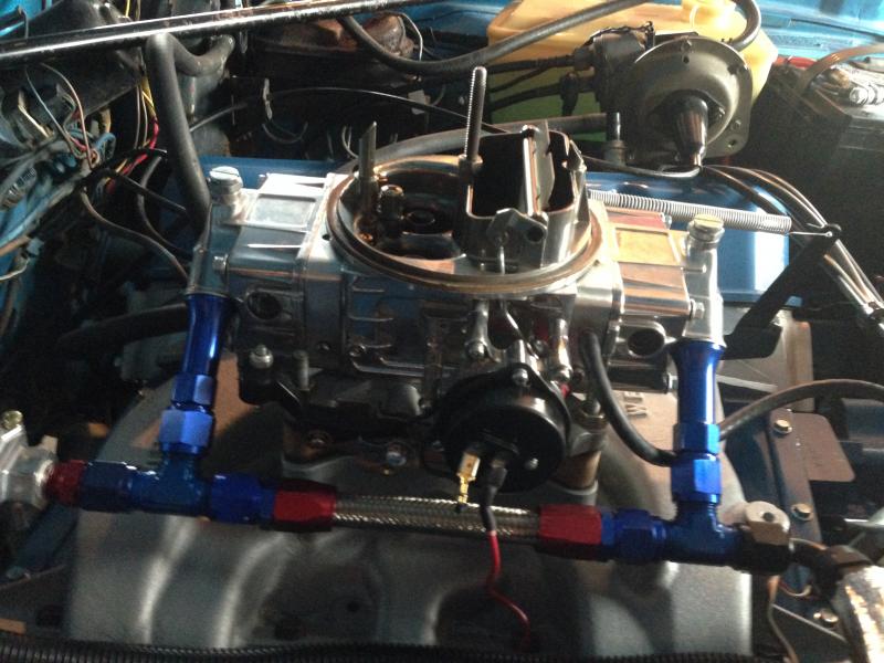

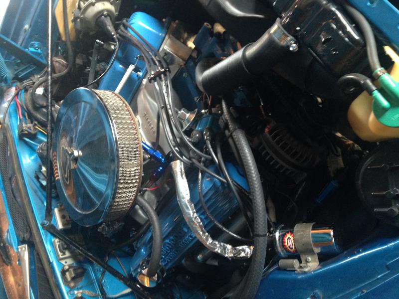

I added 440 source Stealth Heads with Comp cams ultra pro magnum roller rocker setup. Custom ground cam, TTI headers and a full 2 1/2 exhaust system. The transmission was beefed up with a stall convertor. I already had 355 gears so the combination works well. I also needed a new holley carb as there isn't much adjustability in my original Carter AFB.
Surprisingly when it got it on the dyno the 440 was starving for fuel so I added a new fuel pump including tank and dual fuel lines.
Long story short it has around 370 HP and 325 ft-lbs of torque and that was before we changed the jets and squirters in the carb so basically around 400 HP.
It made a huge difference performance wise as now it launches of the line and pulls well through the entire run.
