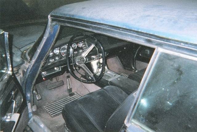

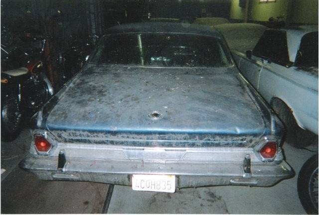

unrestored , hotrodded , your car , your way . did a letter car show here once , drove my 64 300k h/t . just a driver mind you . they put as in the parade going down main street with marching band n the works , drove us into the show . put us on display with although t/q's . was a few drivers . but garaged in bags types . we had a great time . and looked at them all , polishing them like crazy for points and ranking . we'were snubbed , the car had vintage american torq thrusts on it . but they were snubbing the guy that drove his 65 l 413 long ram 4spd car , because his car wasn't oem . the guy put another engine in it to keep the original one freasher longer . he drove from upper ny state to sf bay area california ,
it had all the pics from the transplant and all . but it was like it was a ford or something . lol . so i say have the time of your life with it . if keeping it in the garage does it for you . well power on , but if your a driver , it must be too . key'p da rubb'r syd down n pedd'l down . Scan0020_0020.jpg Scan0021_0021.jpg Scan0022_0022.jpg Scan0031_0031.jpg Scan0036_0036.jpg

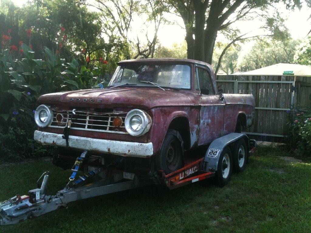

This is the next project on my list....'66 Swepty, swb, 440-727 combo, "just the way it is" exterior, took a long time for mother nature to get the color just right!!!

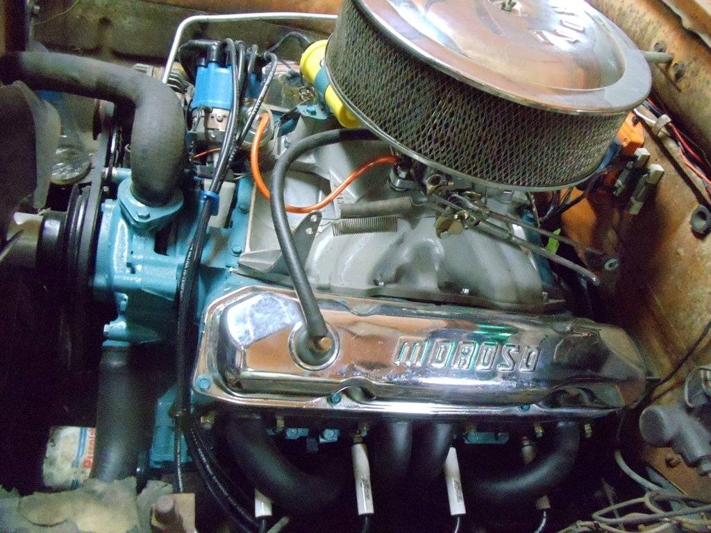

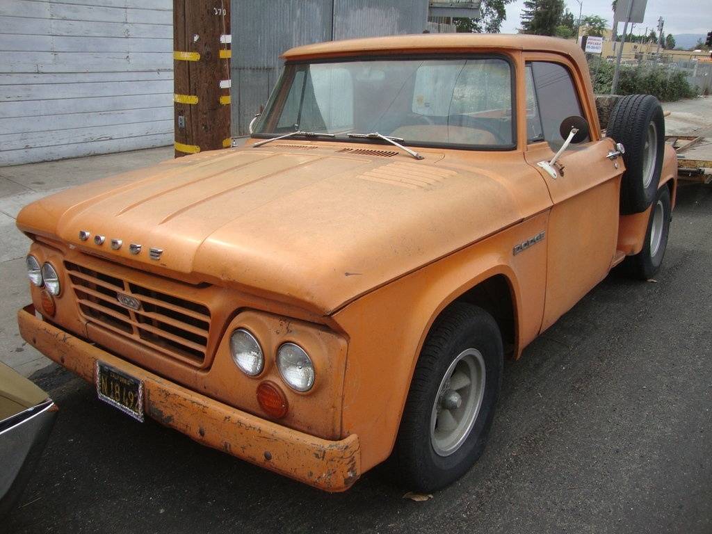

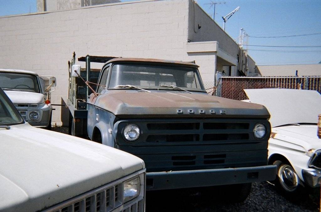

just throwing this swap into a 69 d200 crewcab . its an old statey too . so i have orangy and oranger , lol .
Are they both CA trucks, so no rust?
I sold this one last year....too much rust for me to repair.

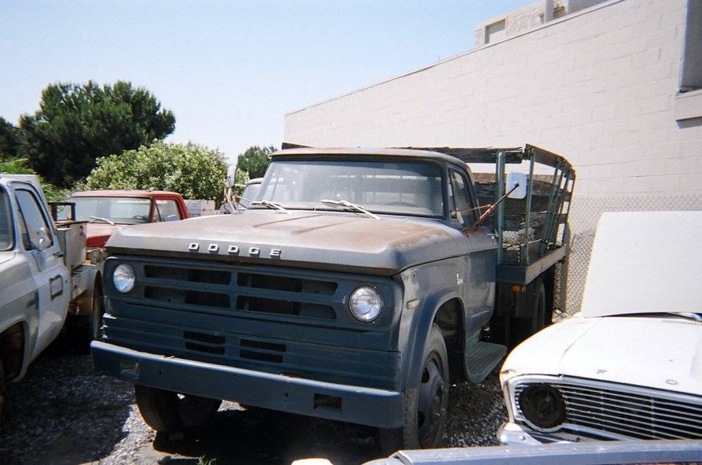

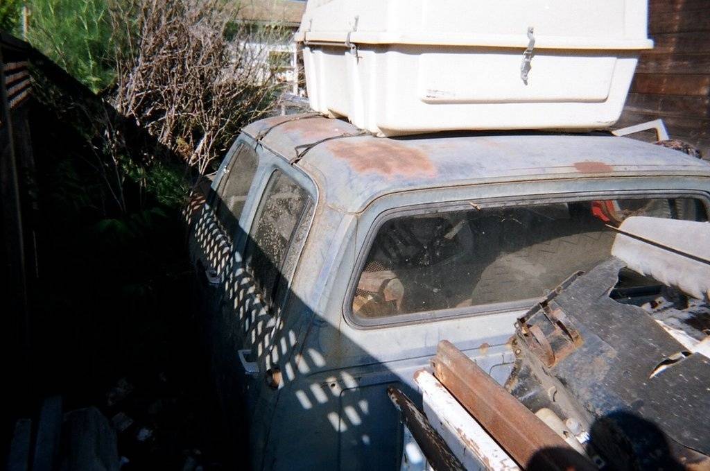

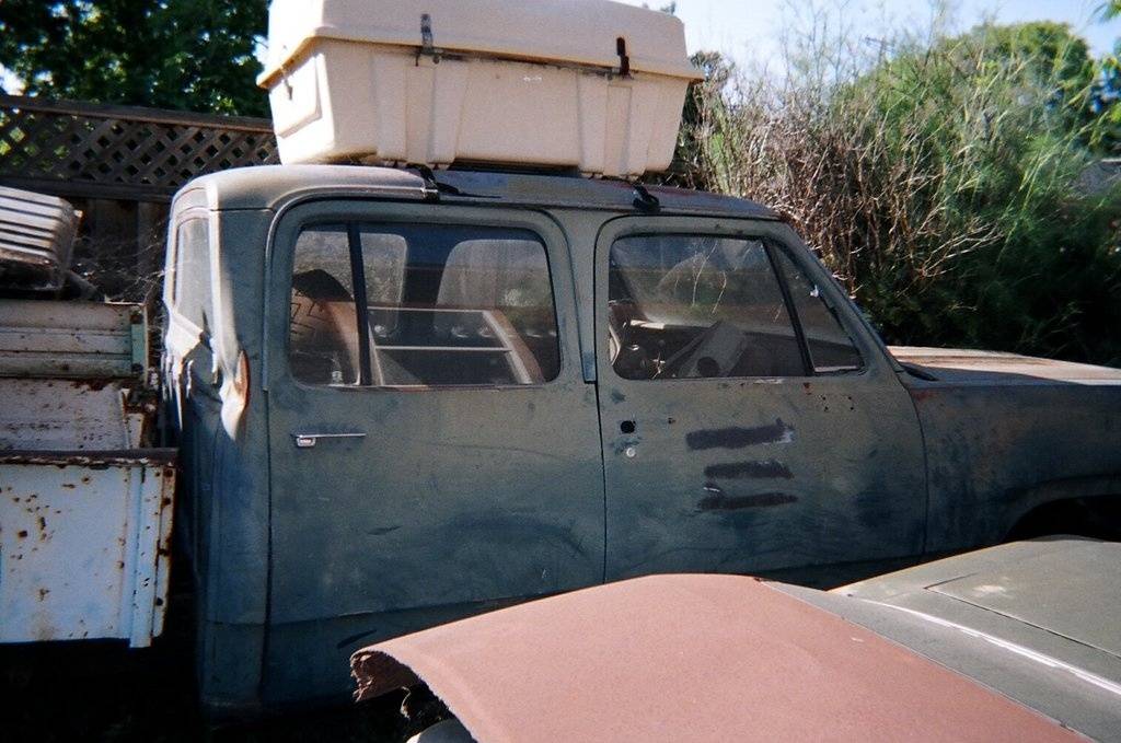

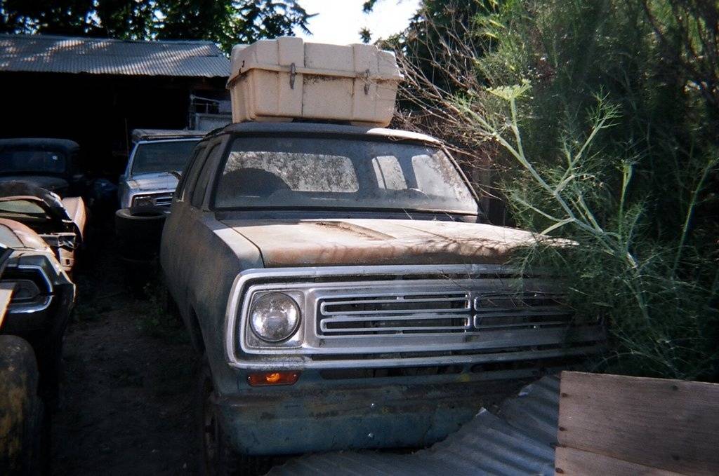

crew cabs are sot after world wide , this one just feel upon me , in kind of a fluke . buddy sent me the sales ad with the tittle '' you hav'nt bought this one yet '' . a tow yard had just listed it . i emailed him back no but is mine i just have to pick it up . bought it from just the pics in the ad . talked with the yard owner we met up and i paid for it on the spot . he brought it to my storage lot . i wash'd n wheel'd so
it as a roller . now it ready to run and get it driven . i know guys that wanted this one . but i got it now . still have guys looking for a complete crewcab body only . there is enough 61-71 pickups around to build one . i have a 72 w200 crew cab , and a 71 d400 thats wants to be a crew cab too , lol .
crew cabs are sot after world wide , this one just feel upon me , in kind of a fluke . buddy sent me the sales ad with the tittle '' you hav'nt bought this one yet '' . a tow yard had just listed it . i emailed him back no but is mine i just have to pick it up . bought it from just the pics in the ad . talked with the yard owner we met up and i paid for it on the spot . he brought it to my storage lot . i wash'd n wheel'd soView attachment 508306 View attachment 508307 View attachment 508308 View attachment 508309 View attachment 508310 View attachment 508311 it as a roller . now it ready to run and get it driven . i know guys that wanted this one . but i got it now . still have guys looking for a complete crewcab body only . there is enough 61-71 pickups around to build one . i have a 72 w200 crew cab , and a 71 d400 thats wants to be a crew cab too , lol .

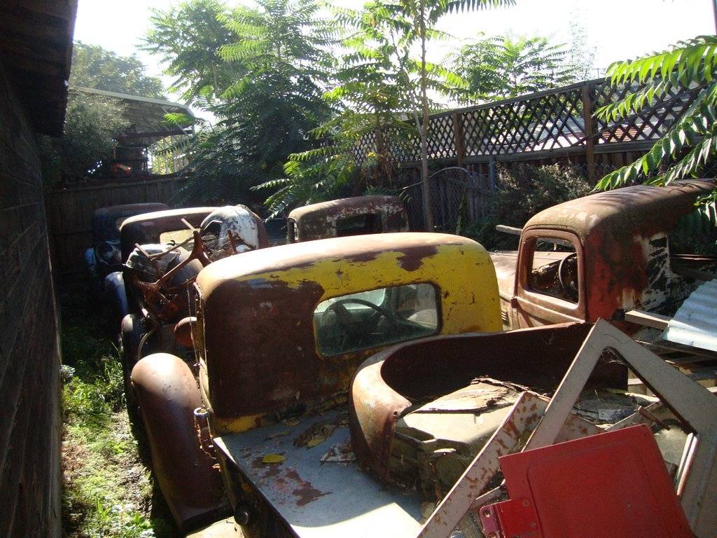

no i haven't joined that site yet . and on a sweptline thought . i purchased a short swept box for my 72 , and grabbed a few nos sets of taillight lenses , got a cherry grille for the 72 as well . i'm thinking a 413 ind with a loadflite out of a class a motor home for it . la's don't do it for me . a b or rb makes so much better torque . my collection is too much for one guys life . but you know , whats a hoard without excess , lol ;)
Sir, you have a hoard for sure, but who's counting right......
Do you actually know how many you do have?
You are driving me crazy with all these cool Dodge trucks!!!:realcrazy:
I'd love to walk through your yard and spend hours just admiring all this american history art work you have collected...don't know of any other place I could see all these Mopars at one time.

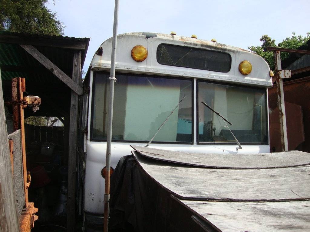

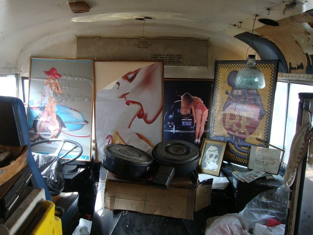

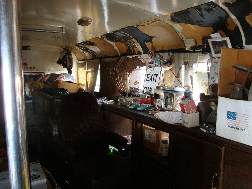

thats just pickup trucks and my ward bus is my library with my car books and hot rod magazines stored in it .
thanks , my shop is a time machine as well . my dad built it with my grandpa and my uncle in 1955 . my dad worked it until about 1991 when my mom passed . tuck the wind from his sails you could say , but he's 86 now and still given me **** about building hotrods . so i know he's good for a few more . i was painting cars n truck before i was driving . now 62 in a couple months . i've thinned the heard a bit . and still got more projects then i can finish , but thats okay in my book , lol . you know i've got muscle cars as well , and i'm into racing vintage stuff as well . and you ask if i realize what i've got , yes i do . but its still fun to dig in and pull something out . to get a new idea going , lol . din din is calling , out for now .

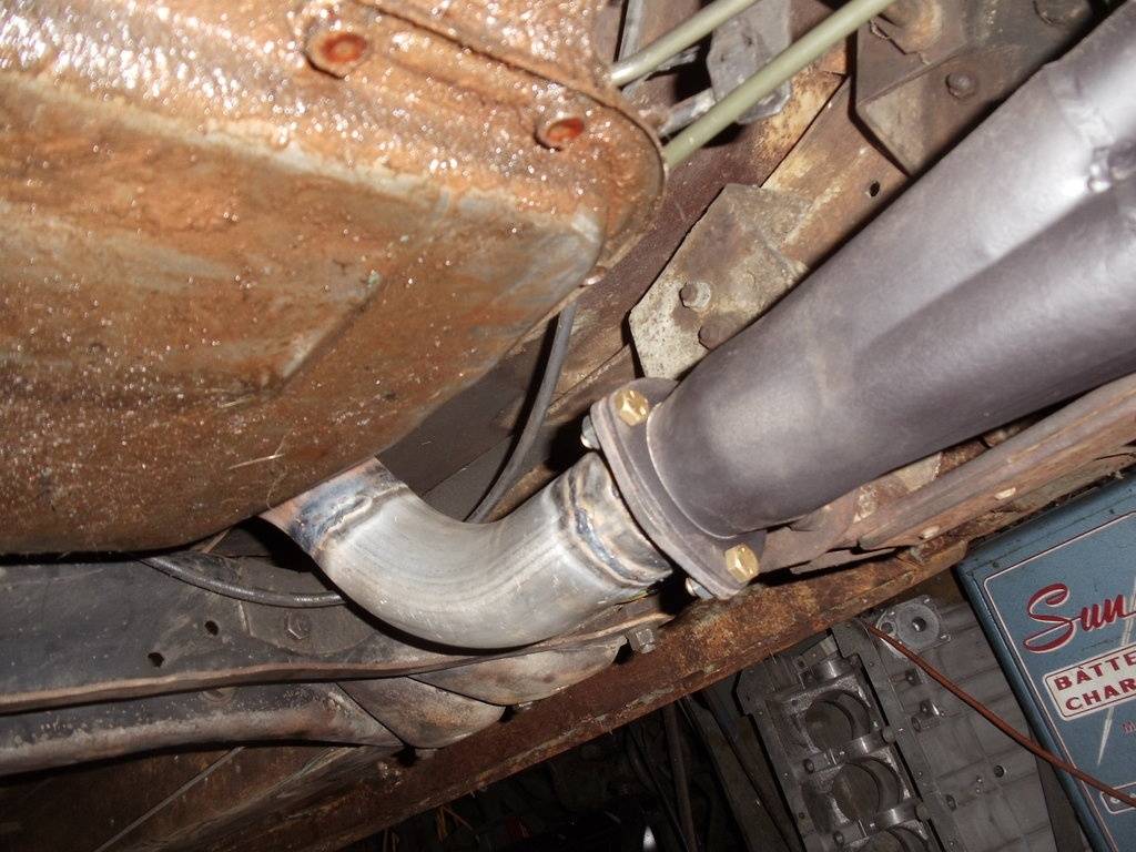

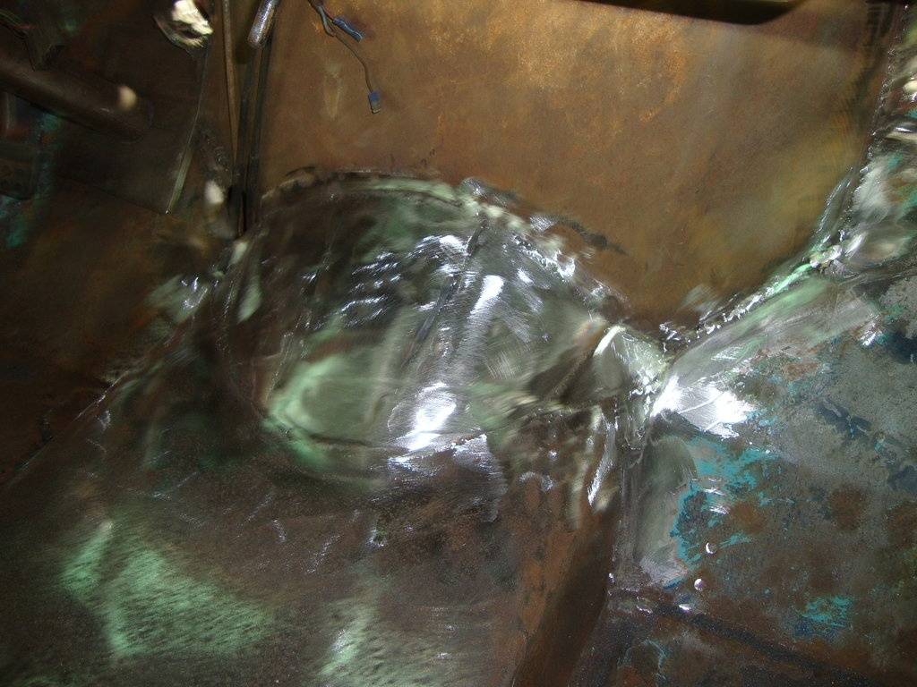

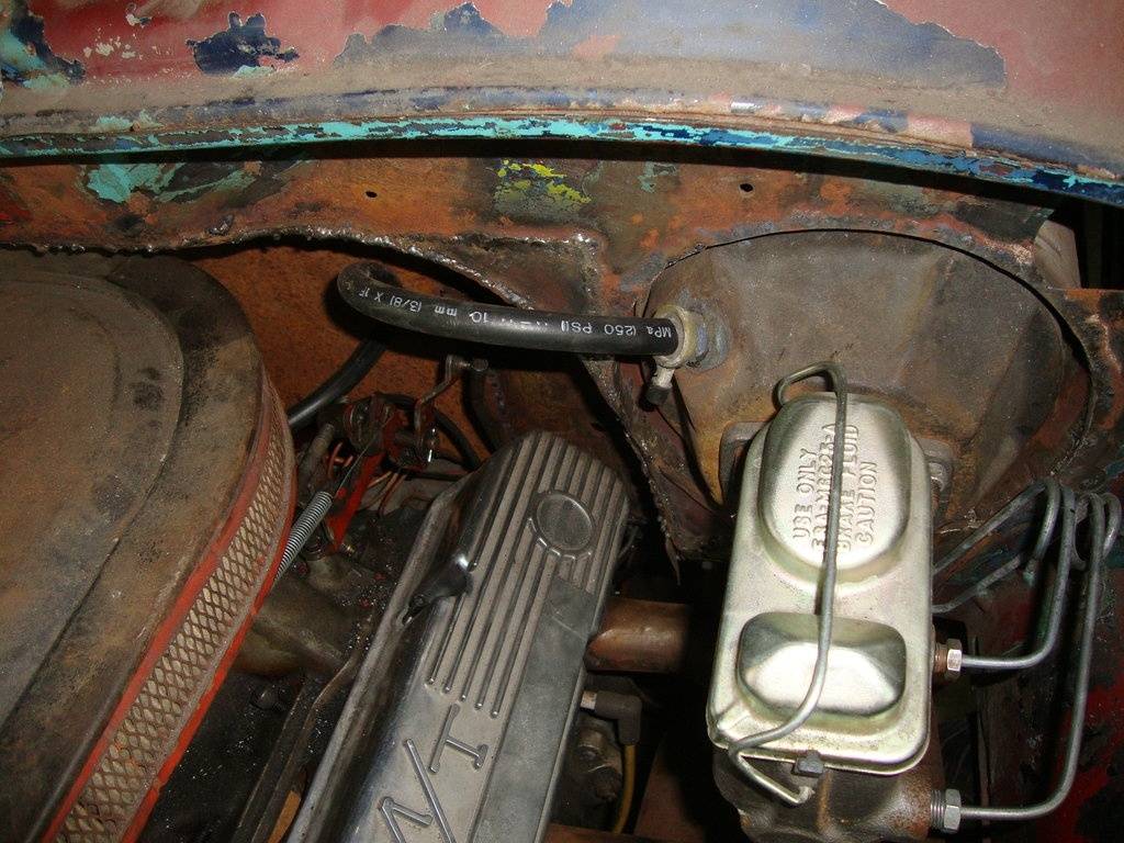

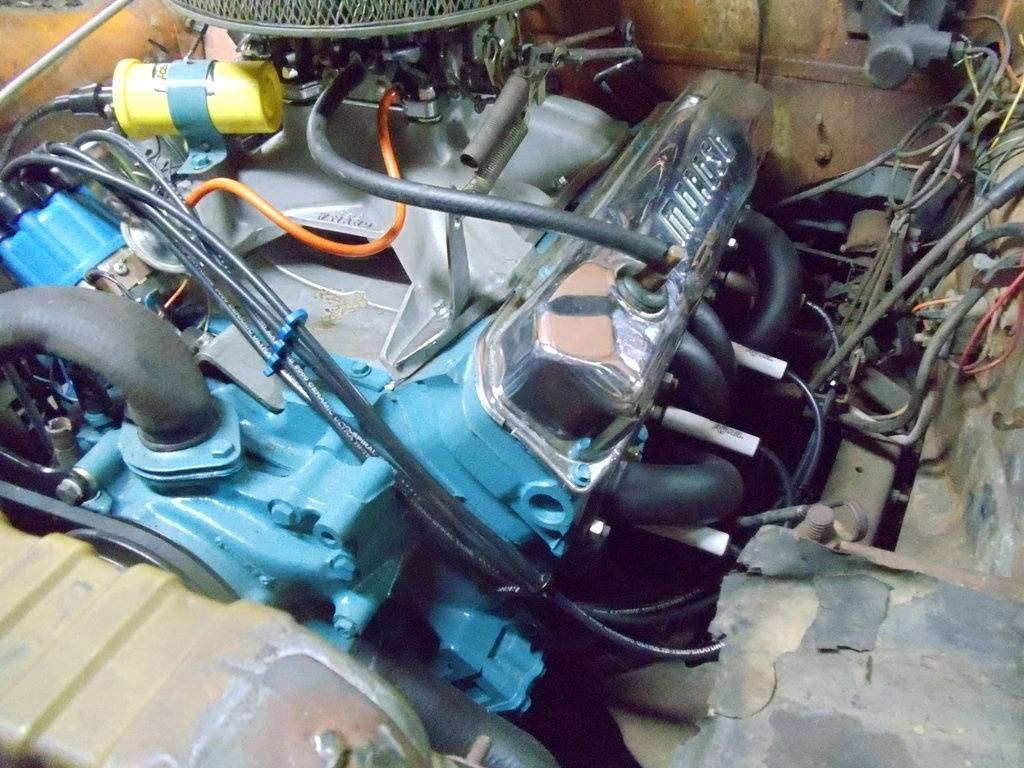

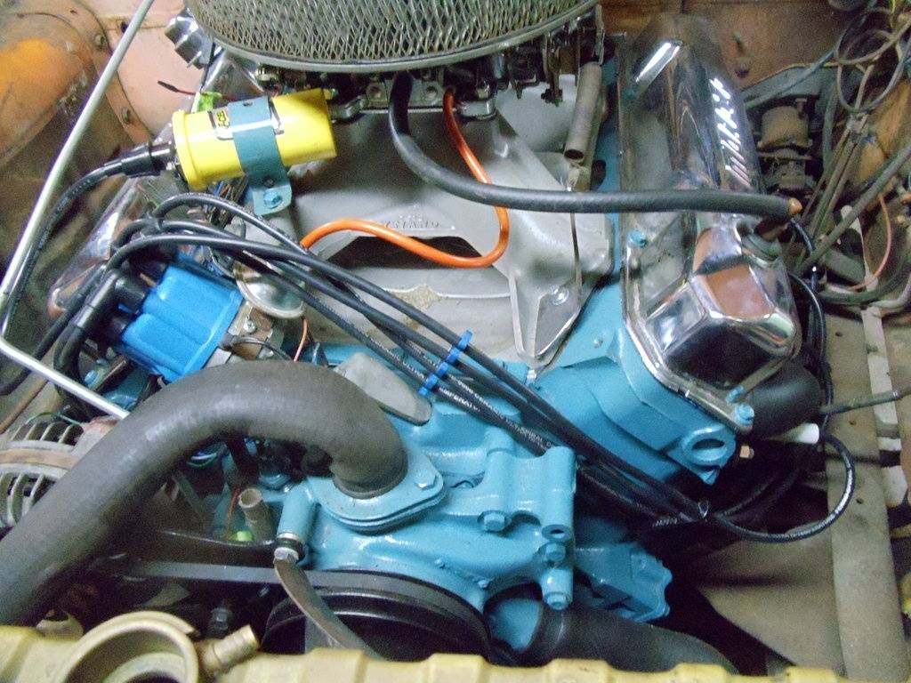

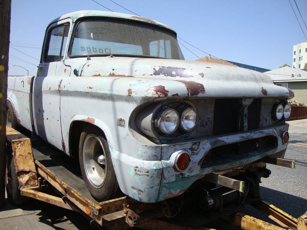

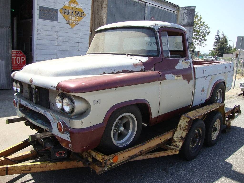

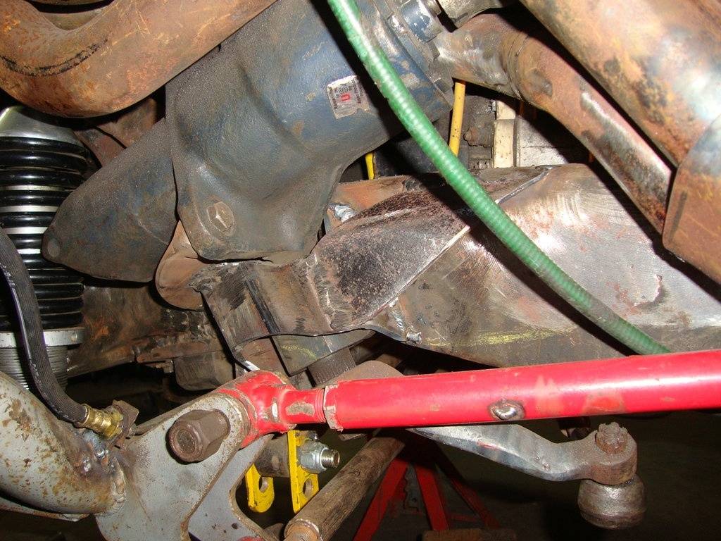

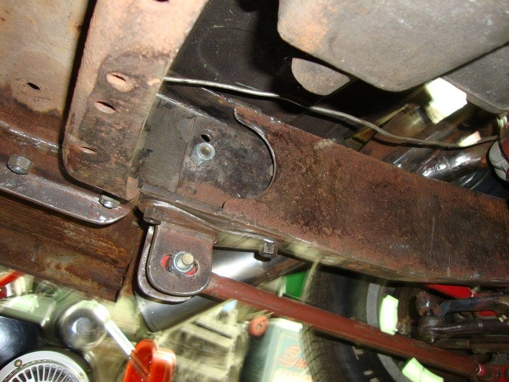

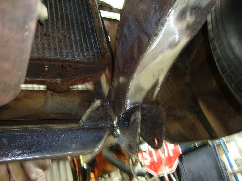

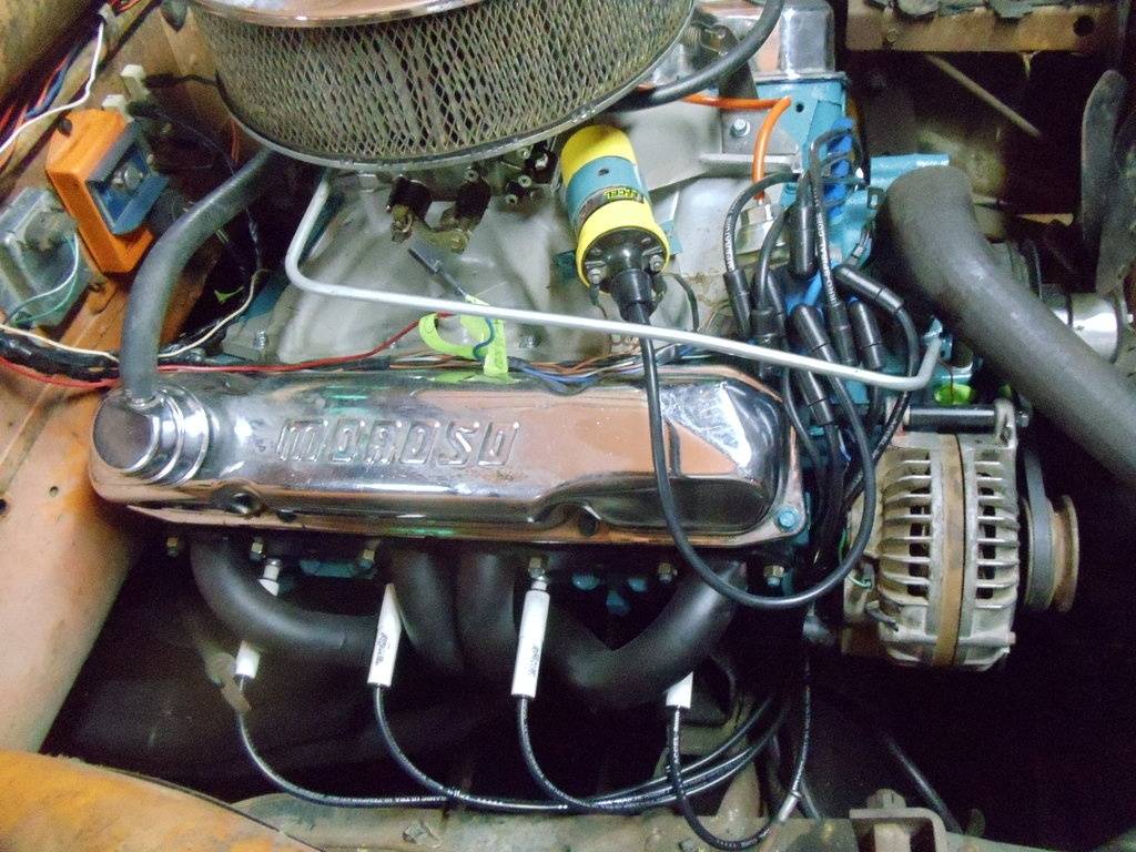

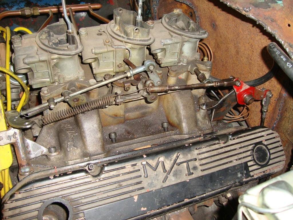

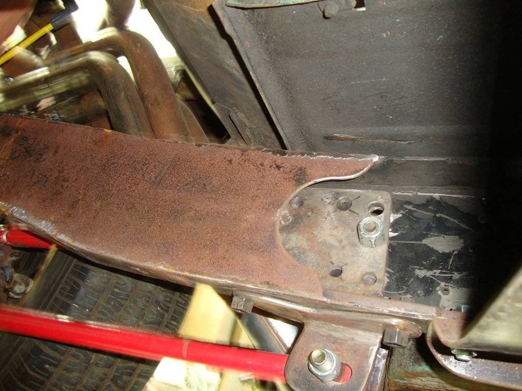

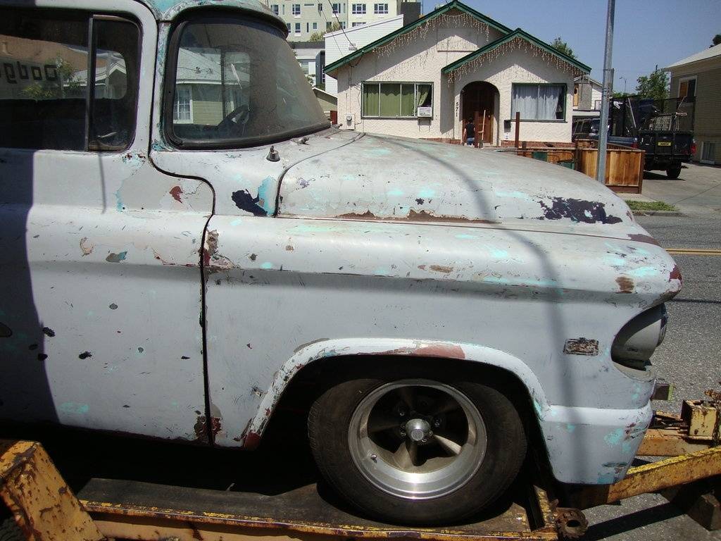

thanks for the support ! my dad is right , yes . heres a few more on that 60 d100 i call it ''phankindodge'' . do to its sume of parts , from cast off other vehicles . i fit it for a 4spd , but just for cleaner . set a 64 300k 727 trans in it . motor will be 468 rb .
Nice....440+6 pack...WOW!

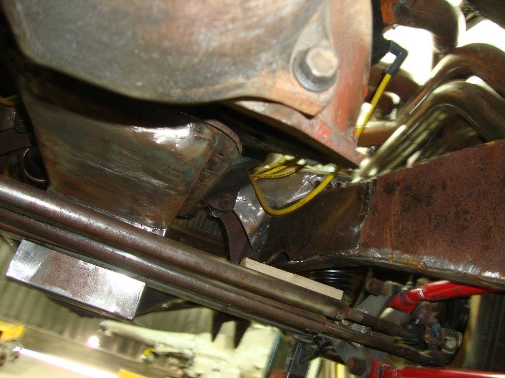

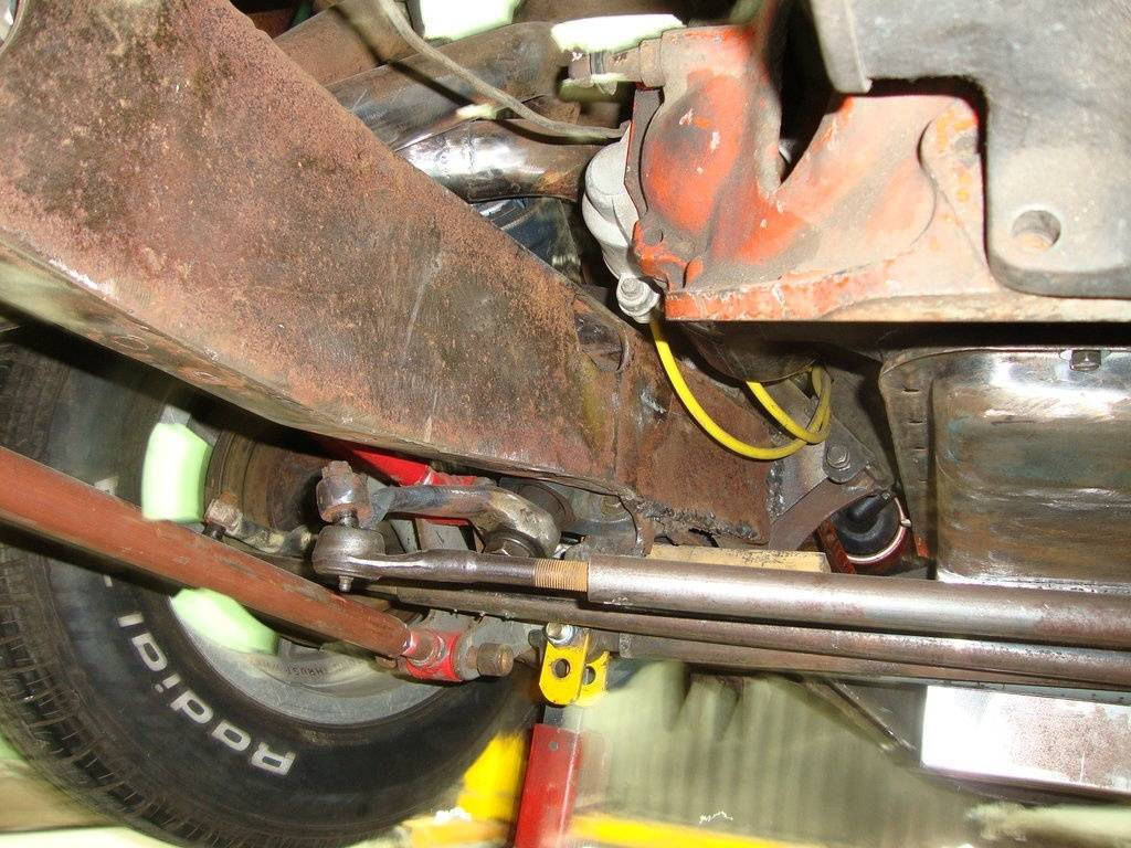

Trying to figure out the front suspension & steering system.
Does it have the original frame, that you boxed, then added some type of 4 link system?
Am I also seeing disc brakes?
Looks like a manual steering gear box from a car?
thats a large output shaft power box chrysler type car or van . yes those are chevy spindles with gm rotors n calipers , but there a little small in dia , so i'm putting 75 d series rotors 11.75 dia , the chevy pickup rotors are 11.88 dia . was going to put all chrysler brakes , but the calipers are to thick and hit my rims weight . yes its a dropped tube axle with four bar and a pan hard rod and coilovers . and that is a 69 6pck setup with mods .
