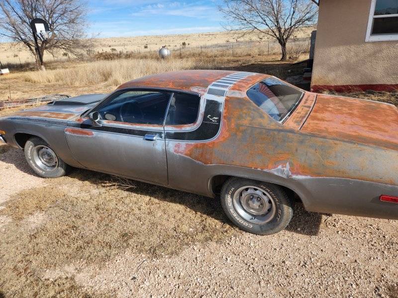

I have been the proud owner of a 74 Roadrunner for about 4 years now. I've used FBBO and FABO extensively over the past few years as a source for information and I figured that it was time to actually join.
I have been a farmer my whole life so I'm decently familiar with mechanical work, but this is my first project car.
Welcome from Alabama, looks like you have a solid project.
Looks solid.
More specs, please.

Sure.
It's a 318 with the 3 speed manual.
It always drove well, but with over 100,000 miles the engine was a bit tired.
I just got it back from the machine shop with a 30 over bore, 0 deck pistons, and decked so that it truely is 0 deck.
I've put a set of speedmaster heads on so compression should be right at about 9.5 to 1.
The cam came from Hughes, but is a Howards cam. Its got .529/.535 lift, 228/232 duration at 0.050, and a 110 LSA. Hughes variable duration lifters and adjustable roller rockers.
Edelbrock RPM Airgap, and a Fitech throttle body EFI.
Hopefully I'll get it started and broke in today.
Anything else you want to know?

There is some surface rust and a couple of quarter sized holes in the inside of the fenders, but over all it is solid. It came out of southern Colorado.
That's an interesting cam for a 318.
Keeping the 3 speed?
