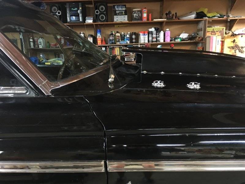

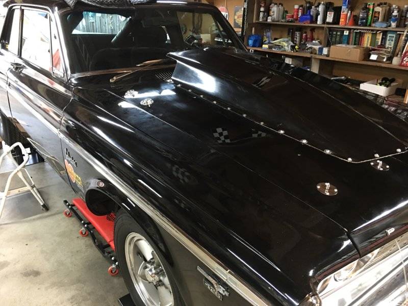

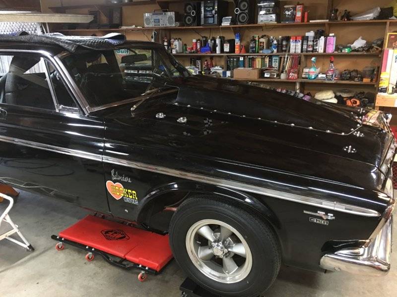

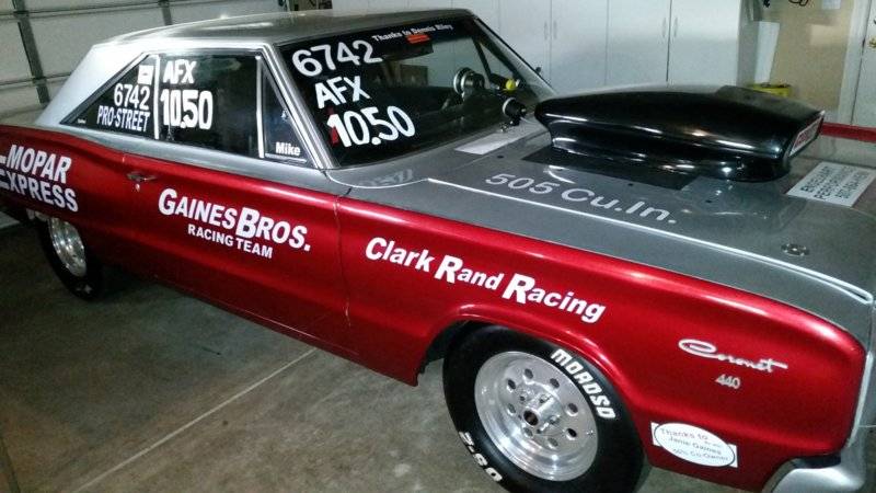

Ron, No, the Harwood Aero scoop is not ok with the AFX / Nostalgia Group here in California. That is the reason I had to spend a buncha bucks on a new 5" Hemi Style Scoop.
While I was doing it I not only bought the scoop but also bought a real lite weight pin on Hood. I had a fiberglass hood but it was more of a "street" weight and hinged...it was pretty heavy.
I bought the pin-on style lite weight hood and then fabbed some mounts for my hood hinges so I could just use Hood Pins (4) on the front only and lift it up as a hinged style.

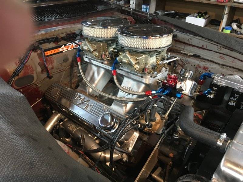

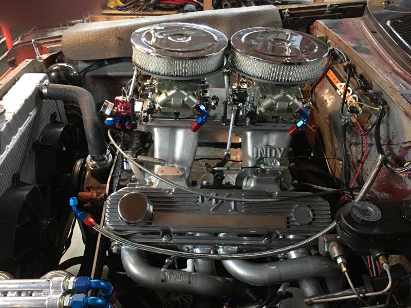

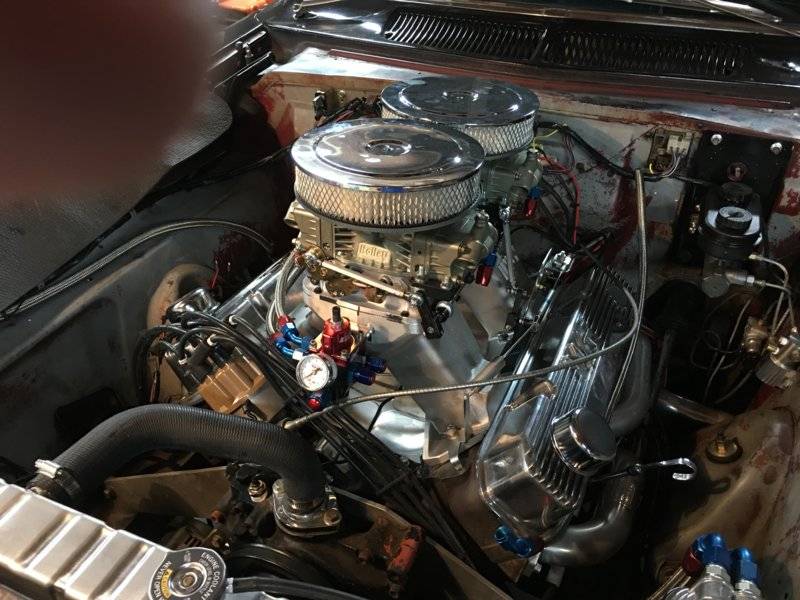

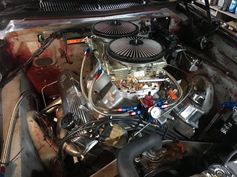

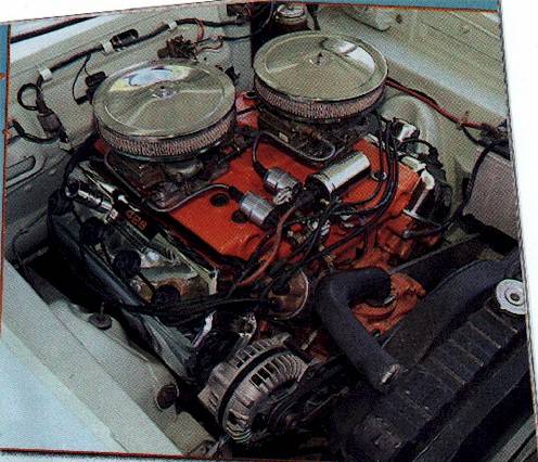

buttoned up and almost ready to fire,,3 fuel lines left to fab and relocate the coil,,,holley tuning time..mainly the power valves..and double pumps..
View attachment 679417 buttoned up and almost ready to fire,,3 fuel lines left to fab and relocate the coil,,,holley tuning time..mainly the power valves..and double pumps..View attachment 679392 View attachment 679393
that looks awesome color me envious. I note the elephant ear engine mount is one piece, that is the only way to make them, two pieces just leak and fail.I have a pattern to make that one piece B body/A body mount, soon as I have the $$ I'm going to get materials and have one made or make it.

i have heard original race hemi holleys run rich and was told to stay away from them unless racing,,,but i'm going to start with the power valves,,no throttle,in gear, brake applied, measure vacuum,,need a valve half the measured vacuum to avoid a rich condition..if its 5",,need a 2.5 power valve,,then on to the accelerator pumps, shooters, and last but not least jets after a trip down the road,,,these r 600 cfm double pumpers..

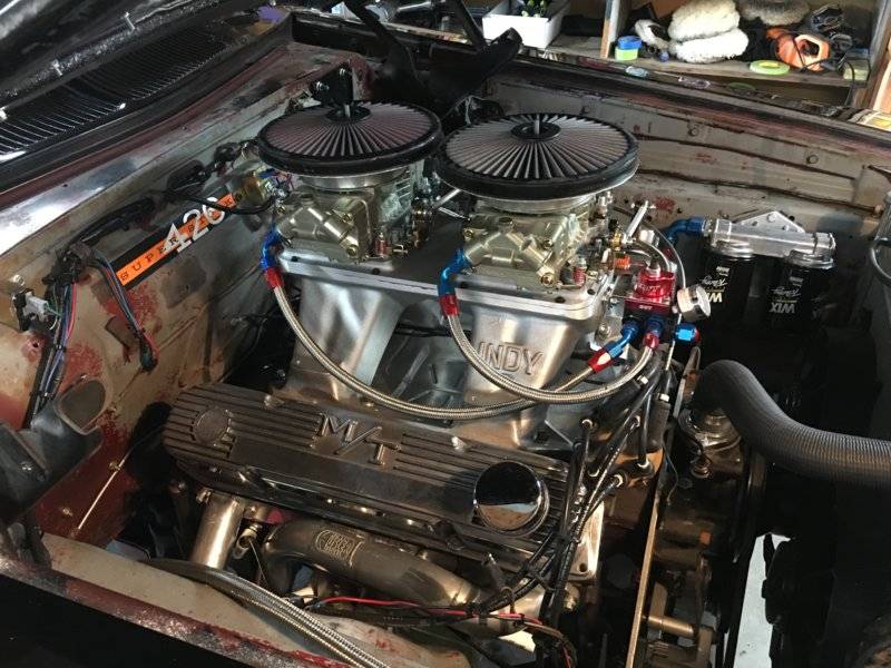

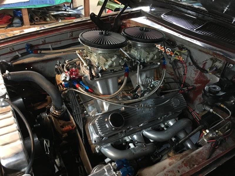

fabbed in the hood scoop today to clear the tunnel ram..4 3/4" high unlimited products scoop..will do more tomorrow to finish,,scoop is bolt on.bond on,or rivet..bolt on for now and check for cracks...yes i know its not mopar but neither is it tech, gm..will paint edges and bolts black....and now i have to get creative on the air cleaners,,i have aplan for that also tomorrow..almost ready to fire..
fabbed air cleaners today after more work on the scoop...k&n extreme air tops on air bells...appx 1/8" clearance to scoop..should work as well as the foam fly eye cleaners found on the baldwin/motion cars with out flaming out upon any carb backfire..
The air bells are they quick fuels 10 5/8"? K&N 66-1101 filter tops with od trimmed down? Nice setup.
yes...trimmed down 3/8" on the bottoms and 1 1/2" on the sides to match the extreme 11" trimmed down tops...aviation tin snips made quick work of them...with the larger tops,its all air cleaner element for flow...9" tops would have bolted on but with alot less filter.

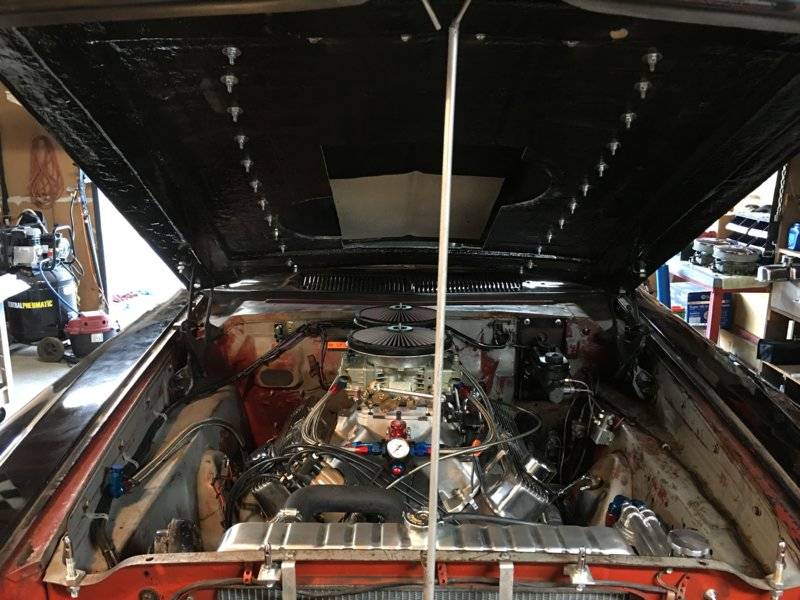

How far are the filters from the bottom of the scoop?
Doug
Doug
only 1 thats close is the front at foreword most passenger side leading edge,motor is factory tilted in car,,,appx 1/8" clearance,,with the motor plate,thats enough,but theres still more i could cut off the bell's before the filter would touch the carb,,
