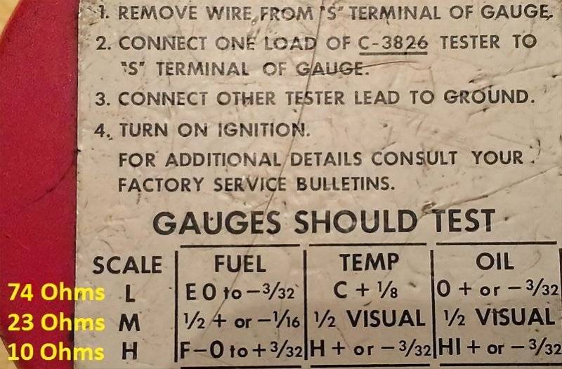

Shade tree. Take a flash light and coat hanger lift the float up and have some one watch and see if gas gauge reacts.
Sorry I was going from memory 10-74 ohms.
Another question for a 67 belvedere. Does anyone know what the ohm range is supposed to be on the fuel sending unit? I have a new fuel pump, new gauge, new float/sending unit and the gas gauge only goes up to half a tank. All the electrical just got replaced too, 100% of it. So, I am wondering if it is the sending unit in the tank, maybe the incorrect ohm range. Any input will be greatly appreciated.

Ok, we got it figured out, the fuel gauge was faulty, not totally bad and the guys at the resto shop said was a way to calibrate it and everything seems to now be working. Thankfully I had another gauge cluster and along with a new float sensore it seems to be working fine now. I had no idea they could be calibrated, it looked like a small gear with teeth
