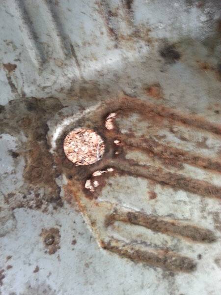

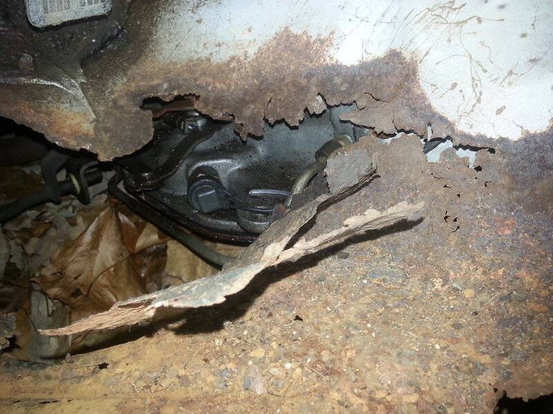

Welcome from south JERSOISY, outside Phiily. See the rust, YOU HAVE MORE UNDERNEATH. Once you cut outside rust out, there's more like in front of tires/behind doors where springs are bolted (inner rockers). Big question is floors: they decent or GONE (Flinstone mobile)? Track done sourse of water getting into cabin is key to stopping future issues; DON'T GET DISCOURAGE!! IT'S GREAT TO CONCOUR ISSUES AND HAVE A SWEET RIDE IN THE END!!!
Top pic not bad (restored car's original floor), repaired: bottom pics from parts car, HEY FRED!!!

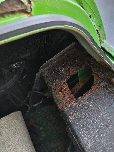

Trunk lid is mostly good, but it's got this giant hole in the corner, and I'm trying to figure out if I see if I can fix it, or replace it.
That giant hole led to...
I have the assembly and welding documentation, I'm thinking I can just pull this piece out and repair it and slap it back in. Would I need to support the car structure if I did this? or can I just work on this part as a single thing? I think I saw a new one of these from a supplier I may be able to use instead.

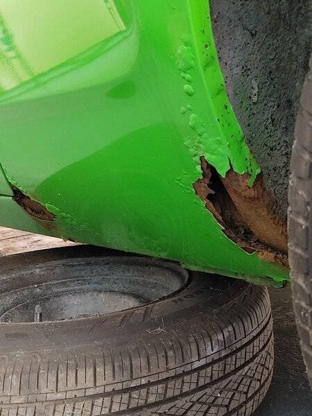

Let me ask you all about this however. Do the quarters right behind the doors rust out because the rain runs down the window into the panel and cause the following?
I think it should be fixable though, I see some panels online. It looks like I have stable metal behind it, of course I'll have no idea until I get into it. Did I mention I don't know how to weld of do body work? I mean, I've got the internet, so I think theres a chance, but it's new to me! I just hope there isn't that much rot behind it. Question, what does it wrap around on the wheel side? Is that the inside of the outer wheel well? It's a little... gone-ish. I'll need to make that exist again.
Going forward, how common is this?
Seems like both sides are a little, eh, but it looks like I should be able to knock the rust off, fill it in, and make it good again, right?
