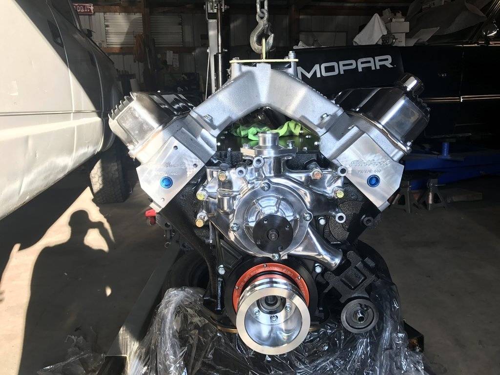

Yes a welcomed surprise! Nope they're out of the box, gonna run them are how we like them and revisit port work laterThat's got to be a surprize! Wondering are those MW heads you have out of the box or was there some work done to them?
Put on a 5.25" billet crank pulley from 440 source and polished pump and housing today
Thanks I'll check it out, I have to order a bolt kit for the water pump pulley and shim kit anyway.440 Source has some very nice aluminum deck rails for the valley plate and aluminum distributor hold down too. Would be very fitting on that pretty stroker.
Agree !! I thought the same thing but !!!, on the dyno rockers hit the covers, IDK but he had custom covers made@ $400.00Hmmm interesting, I imagine the builder checked for clearance.
Where was the clearance issue? On the sides, because I peaked in there and that's the only place I can maybe see an issueAgree !! I thought the same thing but !!!, on the dyno rockers hit the covers, IDK but he had custom covers made@ $400.00
I have 1.6 rockers also but they are t&dI've got Indy valve covers on my MW heads. No contact issues. Although I have Hughes rockers 1.6's.
