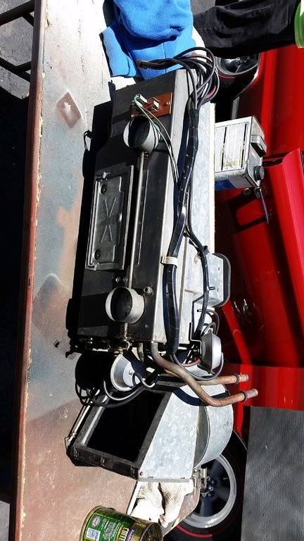

Took the major components out of the case. Few tricks and things I didn't realize to get the heater core out. Didn't realize that the extension pipes for the heater core uses slide on over o rings to seal technology. I didn't think it existed before the 90's. Also on the 2 water drains, because of the dirt and corrosion I had a time figuring out how to remove what looks like 2 top hats, they serve as a backstop for thick sponge seals to firewall. Good news, all actuators are good, I found a NOS vacuum switch and a NOS h valve, sent the Ranco heater valve out to be restored. These are made of unobtanium. Both the 50 year old dual core and the evaporator got a thumbs up from my local radiator shop.

Hi, as I haven't taken the case out or apart yet you can answer a bunch of questions I have.
1. Is the case removable from under the dash without taking the dash out of the car? Yes you can get it out.
2. Is the H valve an actual valve that is hooked up to a cable or is it mearly tubing to hook up both sides of the core? The H valve inside the heater box is linkage driven - replac this one because it is a PIA to open the box again and it is cheap enough. The other H valve for the coolant mounted on the firewal is the expensive one and not available in the aftermarket. If yours is all origional it can be rebuilt for about 150.00 - I you are not stuck on all original there are other aftermarket valves you can use - in either case it is cable driven from your heater controls.
3. Are both the heater core and evaporator readily available in the aftermarket? Both are readily available in the aftermarket. If getting them rebuilt be sure its a place with a great reputation otherwise you will do this again , I have seen several work for a year or so then leak again -
these are 50 year old parts rebuilt or not - I went new

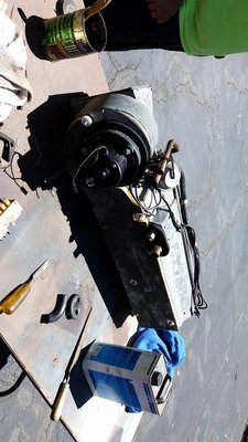

All gone through and checked first on a bench for blower motor and and vacuum doors correct operation. Ready to re install

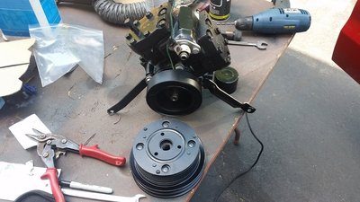

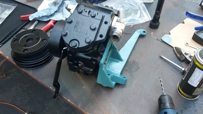

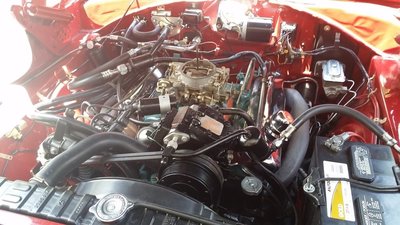

95 percent success, fixed my defroster duct to make it usable . Swapped everything over on the compressor. New expansion valve and drier. Ran out of r12 when charging so didnt get a clesr site glass. Small issues that I hope to iron out. Need forum members input on these.
1. New vacuum switch, mopar part , but one set of terminals are seperate on original but joined on replacement switch. Problem is compressor only disengages in the heat position. All other positions are hot including off.

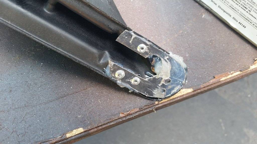

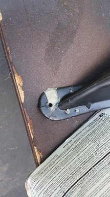

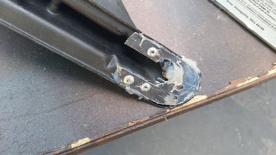

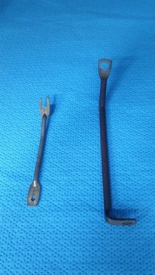

2. Did not take pictures of location of these 2 brackets. Need help identifying if anyone can help.
20170610_170220.jpg 20170610_122742.jpg 20170610_105528.jpg 20170610_105540.jpg 20170610_110155.jpg 20170610_105600.jpg
