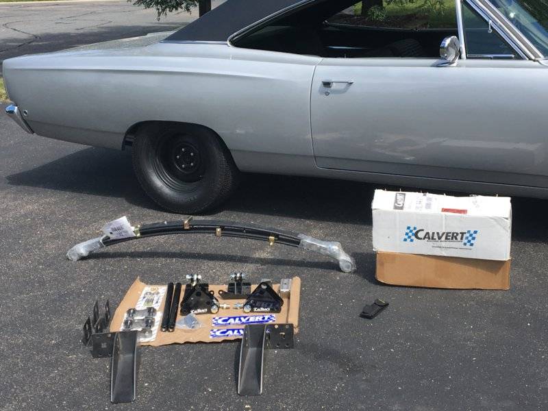

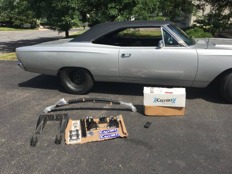

GARY is building my custom length Dana 60, doing spring relocation and mini tubs starting next week if all goes as planned! will be doing cheap rear disc brake conversion at this time as well.

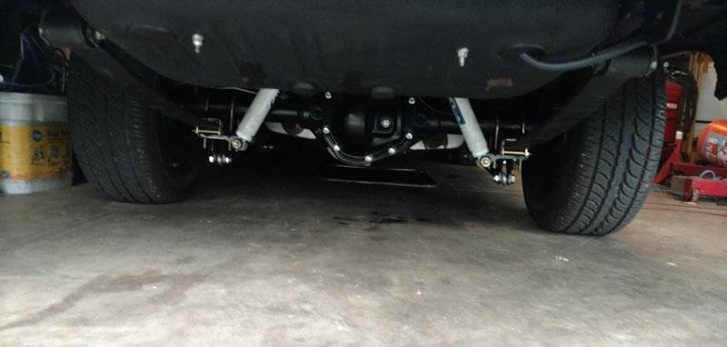

What problems do you have with the spool & street use? Not sure what the pic shows me.
No problem with it I thought I would be doing more racing than street driving but turns out I'm doing the opposite.
Pictures is my new Dana and Cal tracs set up
