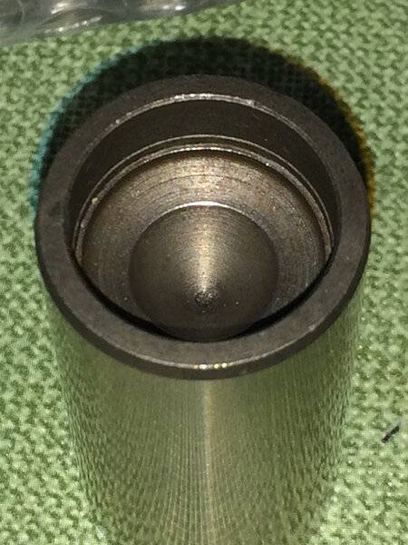

Looking over my new Lunati solid flat tappet lifters & noticed the .035' thick Circlip & pushrod seat floats (rattles) inside lifter body freely with about .024" vertical clearance compared to my older mopar factory solid lifter with tight .0.0" clearance fit. The new Lunati lifter also has an 0.060" oil hole in bottom of seat to inside lifter body..The idea of an extra unadjustable Lash point to pound out a loose part is why I Haven't considered a solid roller lifter setup to start with & didn't see this issue coming....Any info or ideas appreciated,....tom.

It's built like normal solid lifter, 3 pieces, an outer body with separate top pushrod Seat held together with am internal 0.035" thick Circlip snapped into a 0.060" groove but these seats rattle with a 0.023" clearance seat to Circlip..I'm sure the .028" cam lash will beat the snap ring out . Don't know what the 0.060" seat hole is filling the lifter body for as there's no other hole for oil discharge.

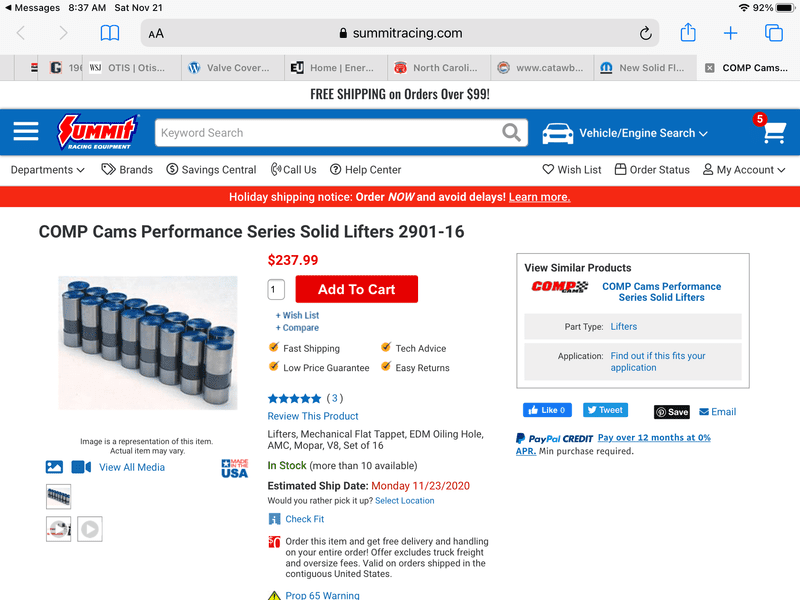

I’ll be using these in my new motor.
https://www.summitracing.com/parts/cca-2901-16
You've got an EDM style lifter. Nothing wrong with that little bit of movement, that's the way they make a lot of them. My Howard's are the same way. There's no hydraulic plunger mechanism inside or anything like that, it's still a solid lifter. When it's writing up on the lobe it's solid all the way through its motion. Don't worry about it...

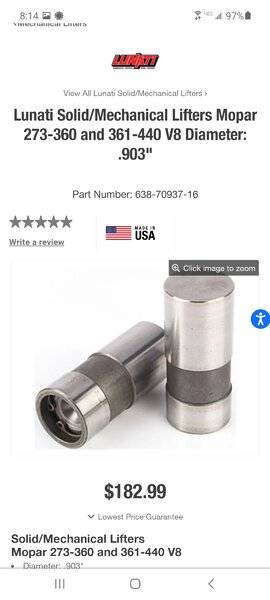

These plain solid lifters are Lunati # 70937-16, smooth sided, No oil band-groove, Non-EDM type, std 3 piece lifters (hollow lifter face-body, Removable pushrod Seat & 0.035" thick flat stamped C-clip/snap ring Retainer. Does Have a pushrod Seat oil entry hole Without any EDM or other oil exit hole & pushrod seat rattles (empty, no oil) with 0.024" verticle clearance within 0.060" inside snap ring groove. Will the .028" lash beat out the internal snap ring ? ... Never seen an oil entry hole on a flat tappet Solid lifter before & don't know it's function ....Anyone know or who makes Lunati solid lifters ? .....tom.

This is an NOS Johnson solid lifter from the 70s. There is no clip! Old TRWs were the same way.
I can only imagine they also produce an EDM lifter as well and use the same body without the oil band and EDM. Maybe they source them through Hylift Johnson. Can't see any reason for the oil metering plate.

Lunati doesn't make Lifters as far as I know ? They 'rebox' lifters from where-ever..... maybe give them a call and ask where they bought them ?
