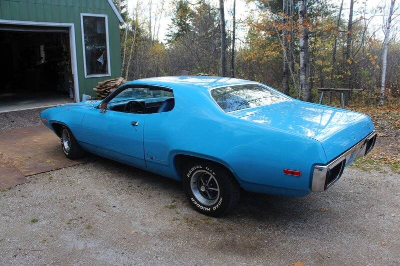

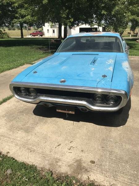

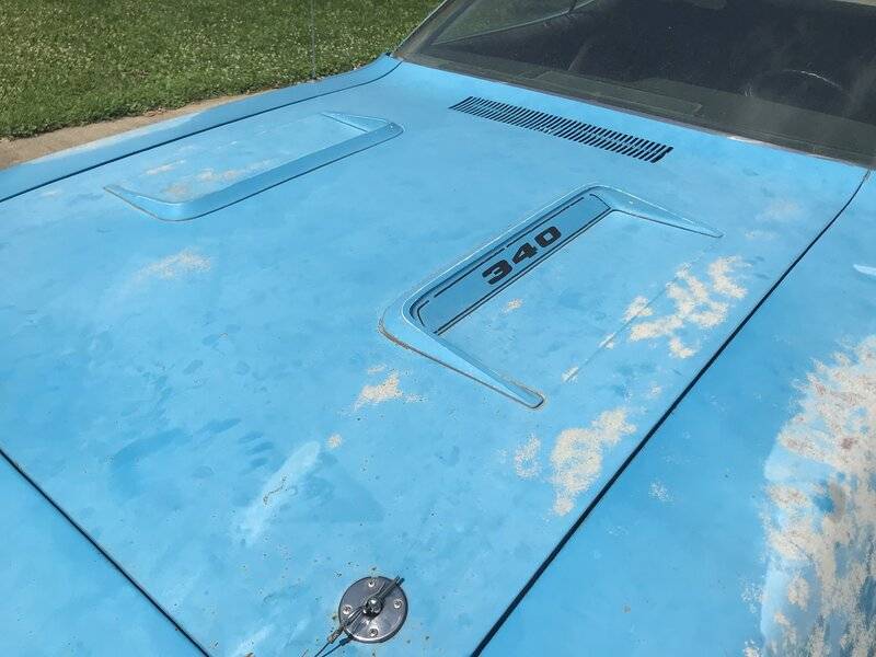

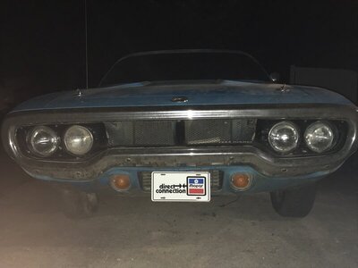

I’m Nicholas, 24 years old living life in boring old NEIA. Just recently bought a 72 Plymouth Roadrunner 340 auto on column, TB3, no stripe, J45 hood pin car. Definitely a project but drivable as is, had wiring issues that were resolved last week and now finally woke the car up from its 25+ year dirt nap this morning. Was able to get car running without dying when air cleaner is off and actually got it to go in gear nicely after changing all fluids. Only issues I’m really having right now is that car dies with air filter on it for some reason (new filter too) and needs gas in carb to even start. It is a hc 1971 318 with 340 heads. Also have where I have headlamps, turn signals, brake lights, hazards working but the side marker light, orange lower valance lights, dash lights, radio and rear taillights are not working at all. Don’t make any sense why hazards and turn signals would work but not tail lights. Any input would be greatly appreciated. Thank you.

Welcome aboard from NJ and thanks for posting pictures. Car looks good! Someone will chime in to help as electrically I suck! Best of luck with your new toy! I am glad to see younger folks interested in these older Mopars.

As stated above, the usual culprit with some of these issues is grounding. Since the hazards and brakes work it sounds like the housings are properly grounded though. The parking lights are a different circuit that along with the dash lights suggests that the headlight switch may have issues. Also remember that dash lights are on their own fuse so double check that. Taking connectors apart and cleaning the terminals can help as corrosion may be an issue too. Getting a service manual here can help too:
