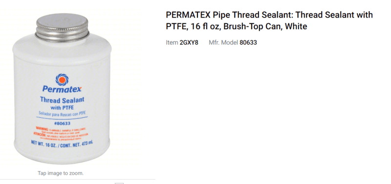

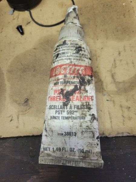

Hey on a related note, I need to change out the studs on my heads (on the bench) do they need sealer on the threads?
Cast iron heads- Hi temp RTV? Loctite?

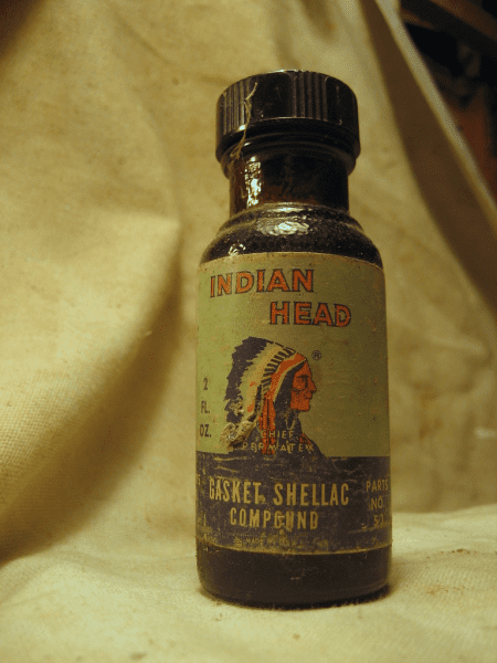

Can you still buy it?
Is it called Native American Head now?
