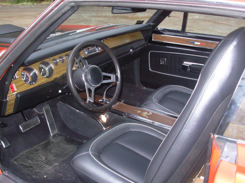

my GTX came with a Tuff wheel. The steering column is standard. DSCN3638.jpg
