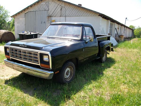

i know its not a b body, this is my 83 d150 stepside, i'm cloning it into a midnite express truck, i 2 weeks ago i dropped in a 78 original lil red express 360, that i had rebuilt to the balls, it dyno'd at 393hp, and 417 torque with headers and a 750 holley, i'm running a 650, and stock manifolds only because my exhaust is brand new from front to back, and i would cry if i cut it up for headers, backed by an 883 out of a road runner, and a dana 60 rear, i just painted the truck over the weekend, and it turned out surprisingly well for an outdoor paint job, with a $27 gallon of black rustoleum, the trick is to double the thinner on the last coat, it leaves an unbelievable shine, with no clearcoat, or hardener, the bottom picture is a factory midnite express, which is what my truck will look like in a few weeks, now i'm looking for a set of wheels and tires, i'd like the cheesy chrome slots that came on them from the factory, but cant find any, anyone got any cragars, welds, centerlines, keystones, telstars, or other that they want to sell in the georgia area ?

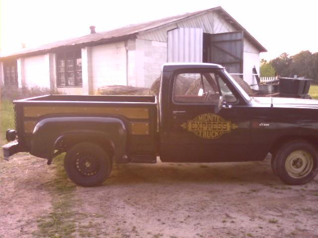

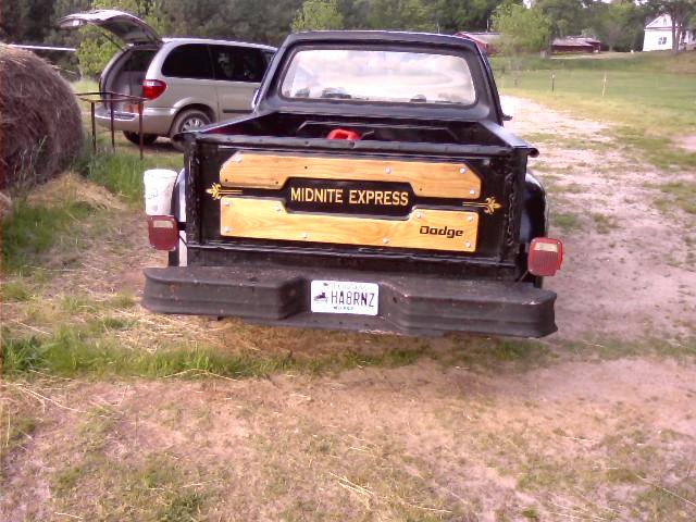

i spent about 4 hours polishing the grill, and painted the headlight bezels black to match the truck, and put the mirrors back on it, still dont believe how the paint came out, the truck is covered with dust, and i can still see myself taking the picture clear as day in the rear fender

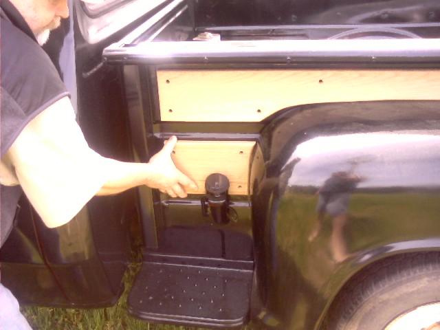

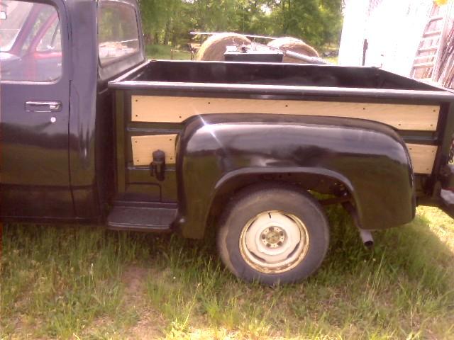

my buddy tom finished my oak sidewood today, it looks great, i still have to drill the holes and bolt it on, the cheapest i could find the wood kit was $295, tom did it for $100, and it looks better than the real thing

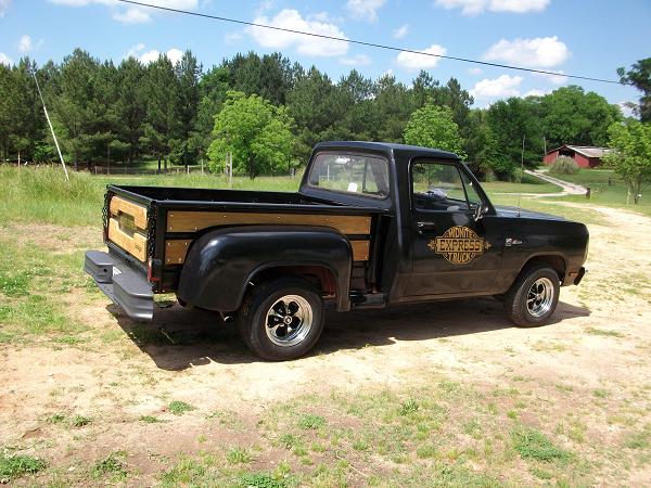

well i decided to go with some keystone classics instead of the factory wheels
