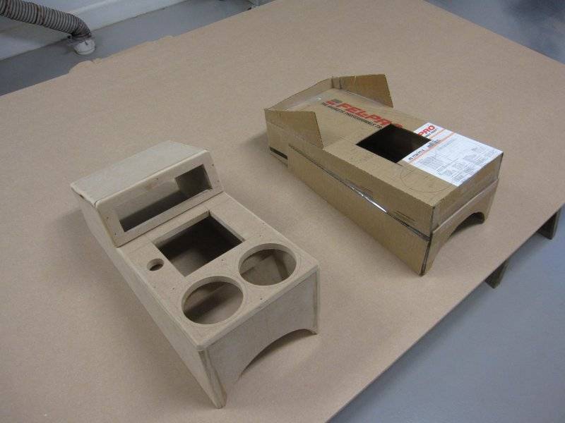

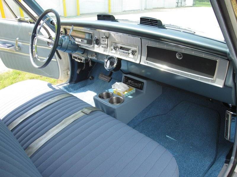

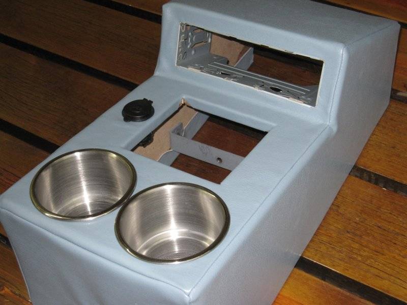

I constructed a small console for my 65 Coronet to mount a stereo head unit, plus 2 cup holders and a cube box of tissue. Put 2 4" speakers under the package tray. I forgot the digital voltmeter with usb charging port!
Mike
Nice set up... I think I will try and make myself something like this.. what material is it made put of ?
