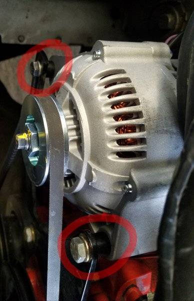

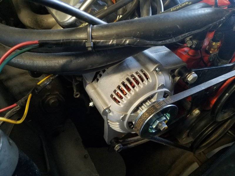

Have you considered a Denso? You only need to add a signal wire directly to battery. I can't confirm fitment on the poly but it fit right on my 440 with some spacers. It is also internally regulated so the VR box on the firewall can be eliminated or bypassed.

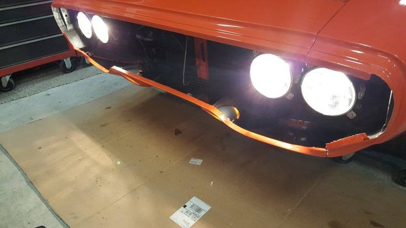

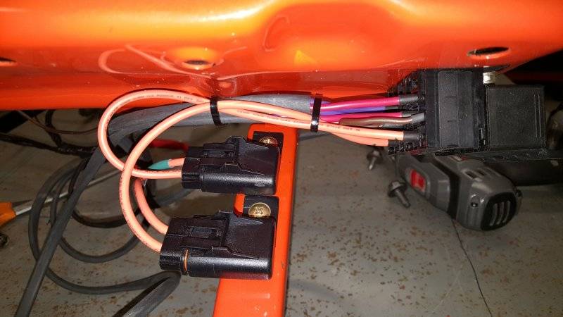

It's a single wire, from the alternator, to the starter relay. A member "Crackedback" makes those and a headlight harness that takes the load off of the whole system, so that all the current isn't going through the bulkhead, through the ammeter and back out again. He's been on here for a while and is a well known here. That's the weakness in these old cars. Just wire it up, fire it up, done. Attached is a picture for his relay/headlight harness I have on mine. I put the relays under my battery tray, on the arm, hidden but they work flawlessly. You don't need a high amp alternator IMO.
