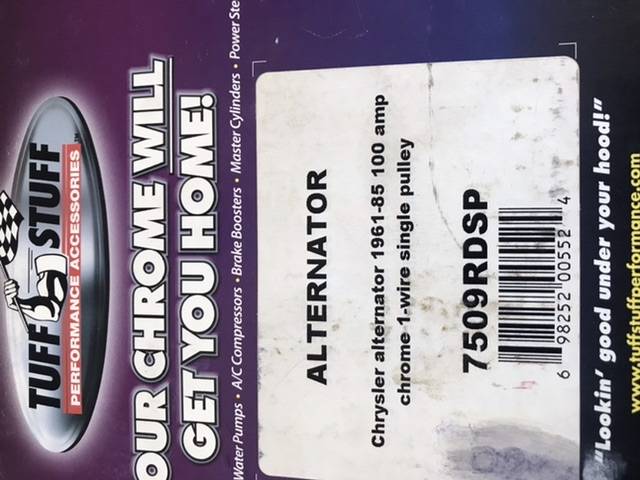

I have a used Tuff Stuff 7509RDSP if anyone is looking for a deal. I went to a serpentine setup with a GM one wire setup.
I can't find that alt PN on the tuffstuff website. Just as a case part replacement. All alts posted there are 8xxx or 9xxx
It’s probably not a current offering anymore. It was purchased years ago and been off the car for several years. It’s a chrome plated square back IIRC.
