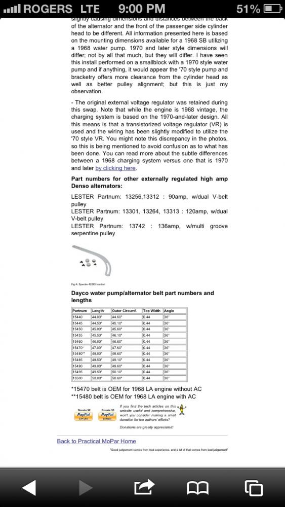

Does anyone have a link to an externally regulated nippondenso 100 amp alternator that i hear eveyone recommend. I have a 78 amp alternator for my 440 engine but am worried it wont be enough to power my amp and a few other electrical upgrades. Looking for something putting out 100 amps and will work with my old brackets. Thanks
Found it
Care to share the wealth, dodge68charger?
Not sure how to post the link but i typed in 'road runner alternator' in my google search engine and its about 3 pages down. Says ' home. Roadrunner.com'
