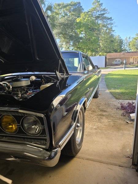

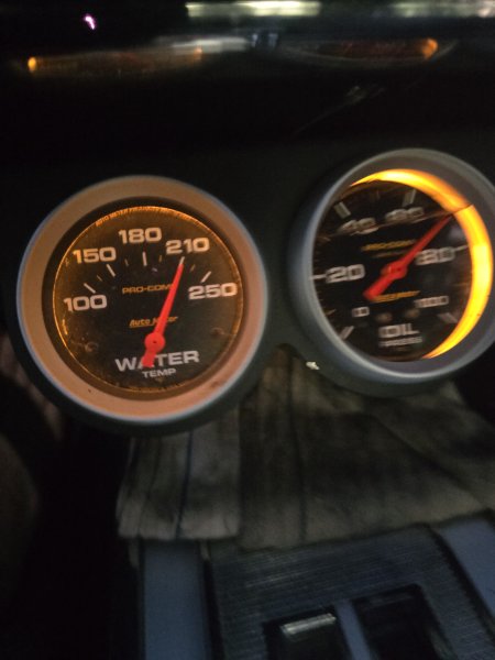

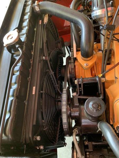

67 coronet original ac car power windows ect. 440 car but not origional motor, 727 trans. Upgraded to new ac system and Serpentine pulley kit big electric fans and 165 amp 1 wire alternator. Because the recommend amp alt for fans was 140 and I only had 95 so after a bunch of righty tightly and lefty loosey I got it all done and I've been chasing an over heat issue. Never happend before I added ac back to car and went electric fans and upgraded serp kit.
Fairly sure that everything is now so close together and heat soaking, there is no air gap..when the fans are on they can't pull in enough air quick enough and get it out fast enough. I'm assuming I need a big wide mouth hood scoop with lots of fresh air. It actually got so hot it boiled my power steering ering fluid. Was also just tuned may be lean who knows.
If you don't mind... what fans are you running? Basically, what diameter and CFM rating are they?
IMHO - they aren't too close... mine are very close (closer actually) as well and the air is moving well. Usually, it's the size and/or CFM that will make for not enough pull... or there's something blocking/restricting the airflow from the front... like an AC or tranny cooler?
Does it heat up when driving (say 55 mph) and cool down when stopped/idle at a light... or the other way around? Or does it just heat up no matter what?
And might as well ask... what is your thermostat rated? 165... 175... 185... etc.?

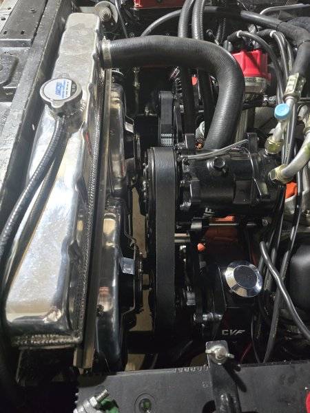

You might try sealing the radiator to the support so all air coming in has to go thru the core. What fans are you employing, specs/brand?

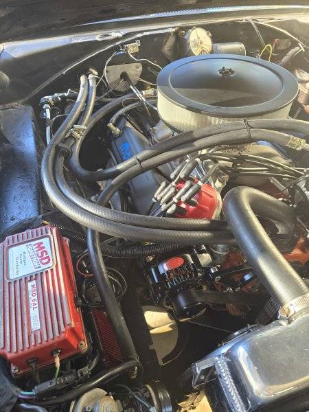

I'm just throwing this out there but did you get the correct water pump with the serp belt system? Water pump turns backwards with serp belts on modern cars, not sure how the retro systems are set up though.
Did you have this issue before you decided on all of those add ons? Seems to be so common, overheating, electric fans. 200 Amp alt, increase the wiring. Damn.

On the serpentine system I have for my 65, they specced out specific pumps due to reverse rotation. Could be the culprit for you. Also asked above: what are the CFM ratings for the fans? Many of them are hardly up to the task. Also, 22" or 26" core. Which one are you running?
I use a pretty basic Summit dual fan /shroud on my Fury with a built 440, A/C, power everything and very tight clearances at the front of the engine. A couple of thoughts:
1) Are you sure the fans are "pullers" and both come on?
2) A valid question was asked about cruising at speed verses stopped in traffic and how temperature reacts for both.
3) A valid question was asked about reverse rotation water pump.
4) What is your initial timing and have you advanced timing to see if that helps?
5) It's possible that there is an air bubble in the system preventing proper flow. Search on this site.
6) 210* is not overheating. A 50/50 mix of antifreeze/water boils at approximately 265*. Is your engine puking water? Make sure and leave an inch or so room at the top of the radiator for coolant expansion.
Initially, answers to #1,2 &3 will help in diagnosing your problem...

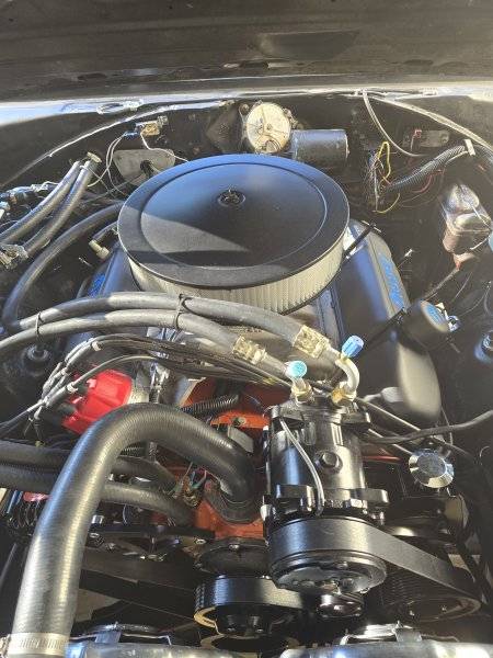

The fans are 3300 cfm each and 40 amps each the thermostat in it is 185 and that's where the car used to sit temp wise all the time. With my mechanical fan. I have an ac condenser in the way now yes and that's my main concern/issue i believe not enough air flow....never got warm with the mechanical fan I went to serp kit and had to go electric fans due to space. I'm going to remove my condenser and see if my issue goes away

I suspect you have low coolant flow I think the serpentine setup might be in question.
But what TYPE of fan(s) are you using? Probably a propeller type? You mentioned that the fans are 3300 cfm....but at what static pressure? Since the fans are "puller" type, any resistance to air flow, measured in inches/wg, (inches of water) will reduce the actual air capacity the fan will deliver. Power consumed increases as either: volume of air required to move, at standard conditions, at temperature increases, the air density decreases the hp required will be less. Propeller fans are very inefficient at high static pressure requirements. The only way to know is ask the fan supplier for the fan curves of your selection. The fan curve will show: CFM vs Static Pressure including hp required at the best operating point.
