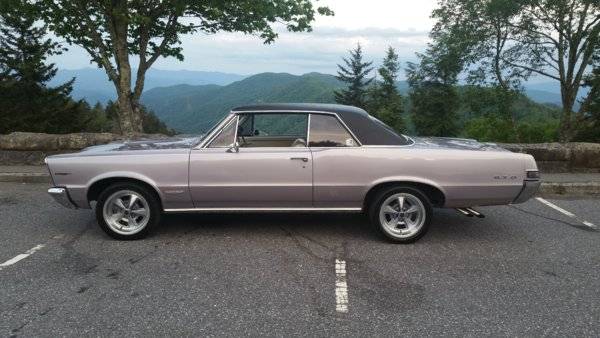

Unless a dealer or owner shoved it in, there weren't 421 GTOs. Not as an option anyway...we know about the two that Jim Wangers built in 1964 so that magazine tests would look better in a comparison to the Ferrari GTO. https://history.gmheritagecenter.com/wiki/index.php/1964_Pontiac_GTO_Royal_Bobcat
I had a steep but rapid climb up the Pontiac learning curve. Jim Wangers was nice enough to sign a pic of my wife's GTO Royal Bobcat tribute. Her car's PHS documentation tells the perfect "story" of what a Bobcatted car could be. Buy a 389 4bbl, get your *** handed to you one too many times, go to Royal and say "Give me the full performance upgrade". Get an October 1965 date coded 421 Tri-power shoved under the hood-which you don't pop, or maybe flash for big money-no way really to tell it's not a 389 without looking at the block casting number under the car...Maybe just say you swapped out the 4bbl for a Tri-power.
Line em up and show them your tailights!
