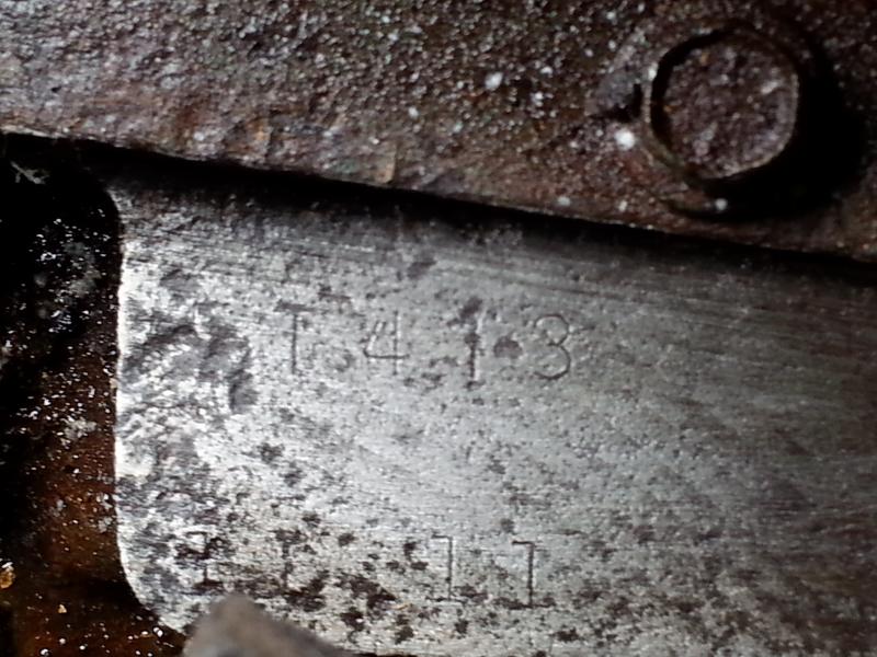

I've been scouring my new(to me) 440 engine and can't find the numbers. I've looked on the pad opposite the distributor and I don't see any engraving. I found an RB stamp on the front passenger side of block and a blank flat plate on the passenger side of the block and nothing on the driver side. I'll get another look tomorrow, probably just missed it. But am I looking in the right places? It's supposed to be a 440 from a motor home. I would guess early to mid 70's
I had to spay paint the pad then sand it to read the #, passenger side of block under the head/ exhaust manifold was where the others are located on mine. Yours should be close.
either warranty block or someone grinded them down I think
Well this is disappointing. My 440 for $200 turns out to be a 1963 413. At least thats what I can find online. Not sure.if I want to proceed with this in my 67 Charger

Is it not worth building? My knowledge of 413's is I know they exist

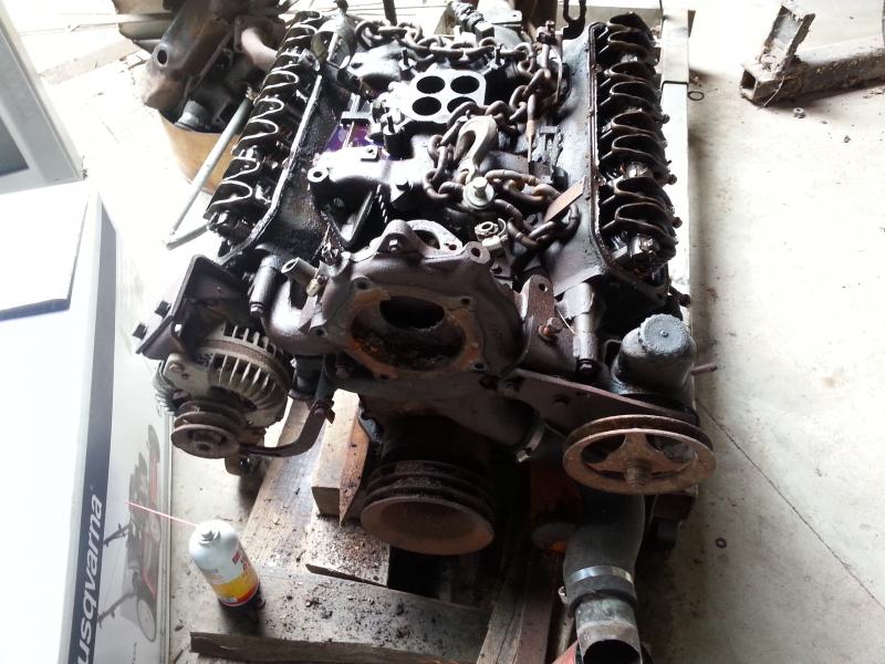

Pistons are the problem if it needs new ones and finding them and then getting them for a reasonable cost. The 413 has the smallest bore of all the RB blocks so using a larger valve with a higher lift cam may get into the cylinder wall. It does have the same stroke as all the RB's so if you need a crank, that shouldn't be a problem. Tear it down and see what it's going to need and go from there. I'm sure the heads on it are going to have small valves plus they may have the high mount water pump setup. If it has those, you may as well start looking for heads too. Can you post a pic of the water pump setup? Also, the intake might also be wet?
I've torn a little off today, but I'd say it's a high water pump setup.
Yup....it has the high mount pump which you don't want to use on car. Notice that is has ports going into the heads from the pump housing.
Thanks for the info. The guy will take it back, but I'm not sure if it's worth the trouble. He's about 30 miles away. I'm going to try and sell it or trade it for something of value to me.
The 413 was used into the mid 70's in the Travco motor home and industrial applications, T 413 would be 1975..
The chart I found said '63. It also had points distributor. Did they still use points on motor homes in '75?
