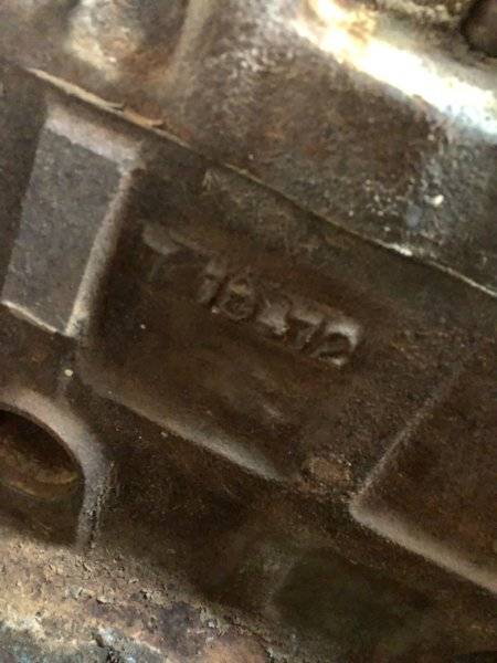

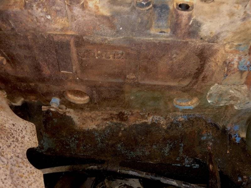

Ok guys, I’m jumping into the mopar scene after building and owning 9 mustangs, I just bought a 413/440 that came out of a 72 motorhome to drop in a 64 Savoy. When I went to look for the casting numbers on the left side of the block all that’s there is the date which appears to be 7-18-72. But that’s it. There’s no casting numbers anywhere. Am I missing something or is there another place to look? Sorry for the poor photo quality but shouldn’t there be some numbers by the date or on the left side of the block?
Also check the rear of the block on top of the bellhousing
Not sure what you have there. On passenger blocks the casting date is on the passenger side & the block casting number on the driver side. Seems to me the '72 casting is a 440. Far as I know motor homes had gone to the 440 by then.
Petcock in the water jacket = industrial 413? I'm guessing here.
Ok found the numbers, they’re on the back by the bell housing. Found them after reading those links Daves69 sent. 2658836. According to that link it’s a heavy 413. A under bored 440? Question is I’m assuming I can still run car 440 heads and cam etc. correct? Or 383 heads? Just like any other RB motor?
That casting number of refers the '426 industrial' block. For whatever reason, it seems the factory often used that block bored to 4.320 for RV and truck applications. It's just a 'raised block', like any regular 440, all 440-based parts will fit.. I've seen many of these in RVs in the junkyards, with all the emission tags and such saying '440' and with that casting number (I'm using one myself!) and they had '440' stamped on the front ID pad, and measured out to 4.320... long story short it's a 440, use it and abuse it like any other.. Just get the compression up some as it will have the pistons way down there... unless you are trying to keep compression down low.
