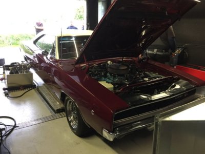

We have a customers 1968 top of the notch dodge charger. It has all matching numbers but with some modifications. The car got a to 500ci stroked indy head, indy valvetrain engine in it. The engine got a different carb, intake, got headers, 2x 3" exhaust, built trans with different converter, etc. etc. It made 585hp on our dyno.

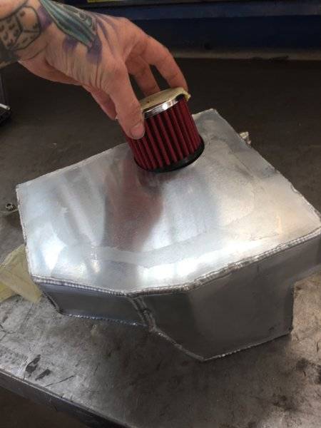

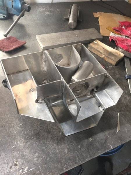

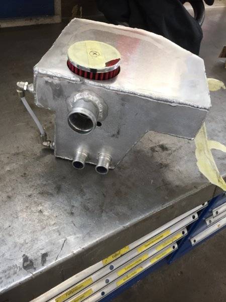

After reinstalling everything i was filling in our 77 high zingg 20W50 engine oil specially for build classic engines. Everything was running fine, but the engine was still leaking. Was much better then before, but it leaked again. After long researching i saw that on some blocks the cranks are not exactly straigth to the blocks, and thats why i can be that you never get it sealed propper. But we still tryed and installed a high perfromance oilcatch can, because i was thinking there could be to much pressure inside the block and thats why it pushes oil out of the seal. So i made all the vents bigger and built that catch can, but it was still the same with the leaking.

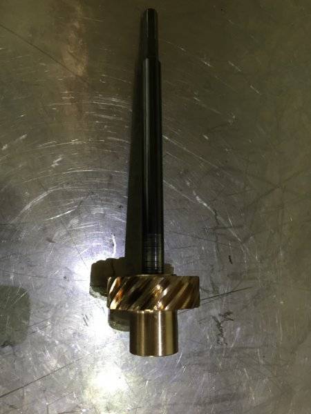

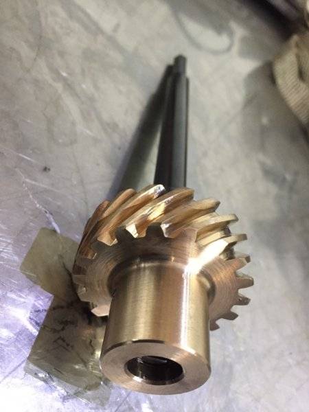

What i did checked after the seal was the oilpump dirver, but it looked fine when i had it in my hands.

a. The oil catch can is COMPLETELY un-necessary

How you mean about the oilpressure about the bearing? Because after the reinstall that it not sit in the excact same place as before?
Or is maybe just the oilpumpdriveshaft not good anymore?
The stock ones are known to fail in high horsepower applications with higher volume and pressure pumps. But usually they break at the tip, resulting in no oil pressure and a ruined engine. I meant that there's a crack in the pump pickup, resulting in the pump pulling in air with oil, reducing suction.
