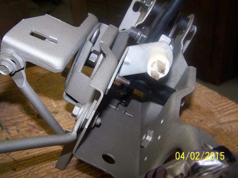

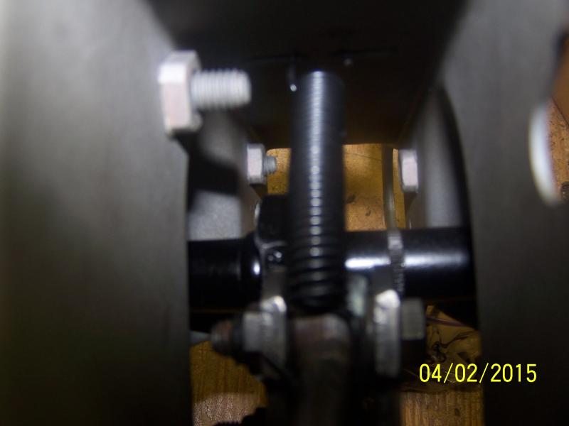

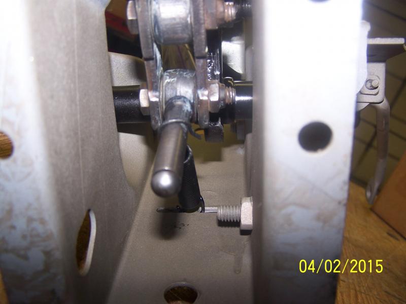

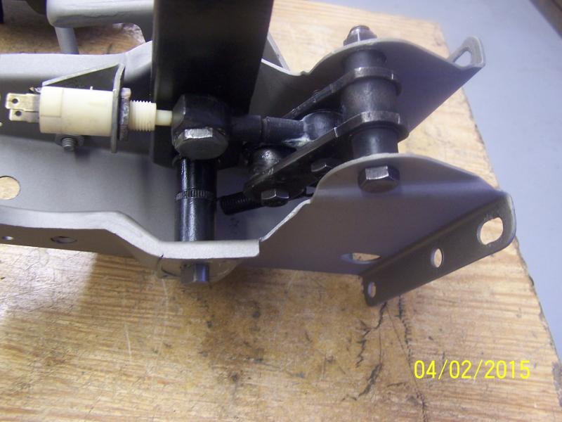

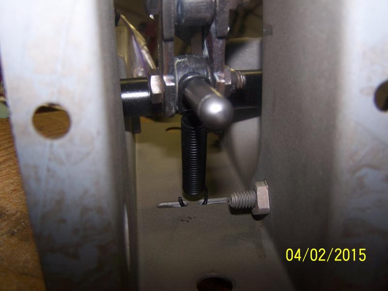

If the car was converted from manual to power disc brakes, there should be a spring in the pedal assembly to pull the pedal back. Some people have added the power brake block and didn't install the spring. If you have power brakes, you should have a spring in there to help pull the pedal back. Here are a couple pictures of what it should look like. (only if you have power brakes) This is from a 68 but I would think the 71 should be the same or similar.

Thanks for the pics ..this help out a lot and yes power brakes and I will look for the spring!!
You're missing a linkage in there too...hmmm I think I may have a linkage and spring in a box somewhere...
But it's off of a 67
Get an assorted mix of springs and find the right one by trial and error... Check for any interfearance
