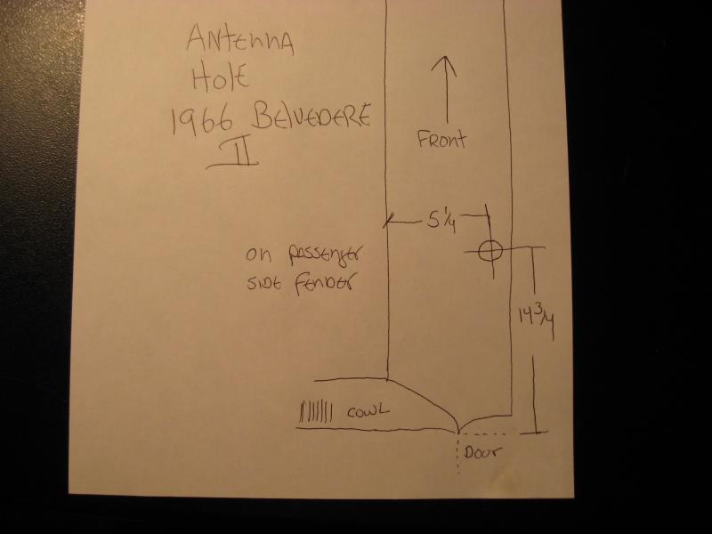

repunch out the hole. if ya need dimensions , let me know and ill measure my 66 belvy for ya!

I might just repunch the hole, dimensions and pics would be awesome, sounds like a winter project.

heres a drawing of the dimensions.IMG_0046.jpg before you ask..i DO NOT know how big the hole is. youll have to fit it to the antenna you get. theyre all over EBAY.
Use a magnetic pickup to find the original location. Should be able to locate it and figure the size pretty close and just punch it in the same location. Just use a rubber glove between the magnet and paint to prevent scratching.

...oh and I'd be carrefull drilling and cutting into an area tha tyou know already has body work. You could end up making a real mess depending on how much filler is there and where any welds and extra metal might be. if it were me, I'd be tempted to remove the fender and look real close at the underside.
