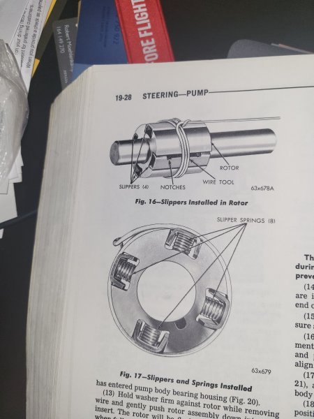

What type of pump is it? The pump on my 67 has "slippers" on the rotor that pump the fluid. The symptom you describe is consistent with my experience when I installed them backwards by mistake one time. Pump would only generate pressure at high RPM. The notches have to face the right way as shown below.
