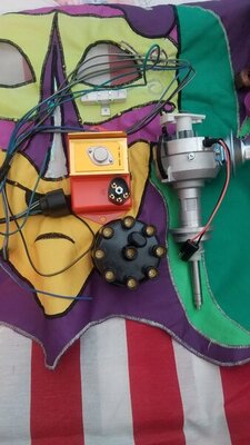

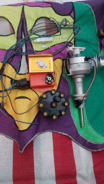

I just purchased this little jewel last week. The guy I got it from said it would crank but no start. It's got an older MSD setup from box to distributor. The car has been sitting for a few years and when I pulled the cap off, it was full of corrosion and rust. The coil was leaking oil and the ballast resistor looked old and tired. I cleaned up the dist., replaced the coil and ballast, but nothing, nada, squat! I think the old msd box is gafunked.
I ordered a complete new electronic ignition system today and hope this will cure my problems. New parts should be in by end of the week.
View attachment 998169 View attachment 998170 View attachment 998171

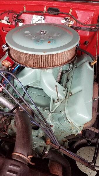

Looks like a vintage 361 or perhaps a 383 with an Edelbrock Torker Ii manifold. Suggest you contact Halifaxhops on this site for a points type distributor to get it running....and then switch over to an electronic system after you get all the bugs worked out.....but it's my opinion just keep the origional setup for an occasional use vehicle. There are others that will disagree and push for an MSD or Pertronix or Revinator or similar system but your car started out life with a points system. It just may be the easiest thing to do to start out with.

Thanks for the input....Its a 440 HP2 engine, not sure what year yet as I have not looked at the actual engine production numbers. I ordered an electronic ignition package for it to replace the old MSD system. Im pretty sure that once I pull the old dist. and MSD box and replace it with the new system, it will be running great again!
Let us know what you went with. If it's a Mopar style electronic, be sure the ECU case is well grounded. MSD's do fail. Although my first MSD 404BC (mid '70's) which had the rep of somewhat poor reliability, mine lasted for a few thousand runs. Keep us updated.

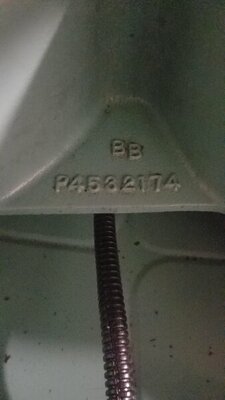

zeek, good luck with the new ignition, let us know which version you got. The intake appears to be a later model Mopar (or other aftermarket) piece. Does it have the casting number/model cast on it? Any idea which carb it has?
Sorry, I didnt notice this question before. It does have a casting number on it but I could not find a cross reference for it. Here's a pic of it.
EDIT: Never mind....I just did another Google search and came up with lots of info. It appears to be a Mopar Performance single plane manifold.
Good manifold, will want a fair amount of gear & may take carb tuning for street use.
I got my new electronic ignition kit yesterday. Waiting for Sally go leave before I can work on installing it. Quick dumb question......does it matter what position I mount the ignition box on the firewall relative to the mounting holes? Looks like I will have to mount it with the holes in the horizontal position so as to be able to pick up existing holes in the fire wall.
You can mount it any way. Just make sure you have a good ground connection of the ECU case. I sand the paint off the back of the case around the mounting holes & around the mounting hole in the firewall.
