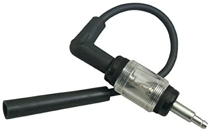

do you have spark?
No time to do much today but I did put the test light on negative coil post and it did flash while turning engine over with key, put it on positive coil post and it stayed lit while turning engine over but it did have a pulse to it. Going to get back on it tomorrow.
they sell these at local auto stores
https://www.amazon.com/Lisle-20610-Inline-Spark-Tester/dp/B0002STSC6
