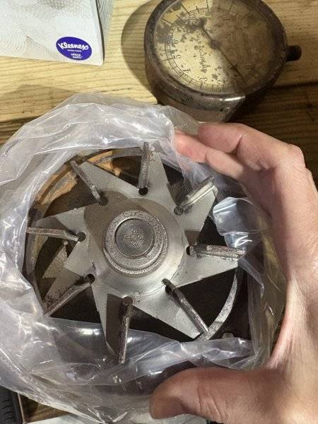

The power steering belt does not go around the water pump pulley..... it is only driven from p/steering to the crank pulley. I might
have the correct single groove water pump
pulley.
