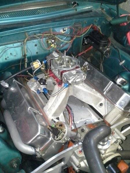

On the 499" with 2" headers, I had problems burning plug wire boots so I finally bought some Accel 9000 ceramic boot plug wires.
The 499" was running a carb, and converted to the FiTech 1200 PA throttle body EFI, and running it with an old lean burn distributor.
