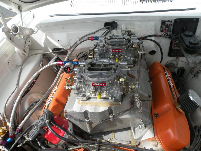

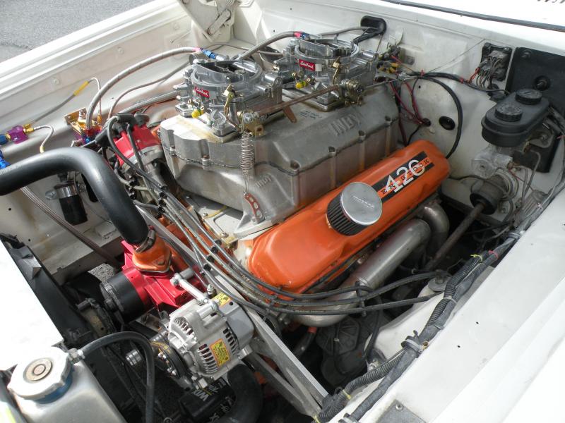

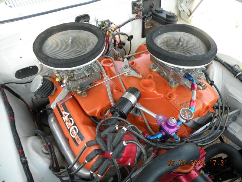

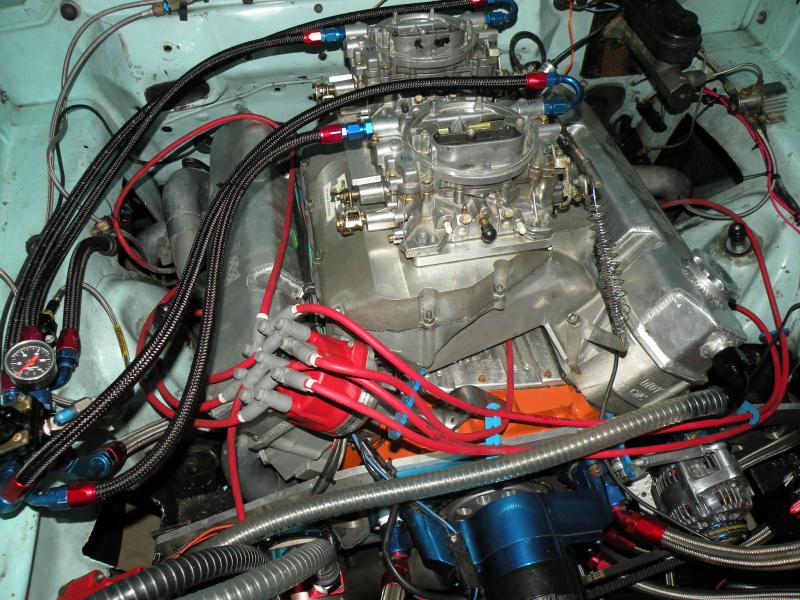

You can also use an inline 2x4 or 6pak,just no tunnel rams or sheetmetal intakes!You'll need alot of engine to use the indy bathtub pictured efficiently!

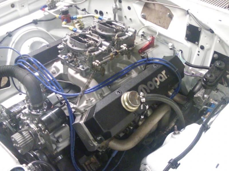

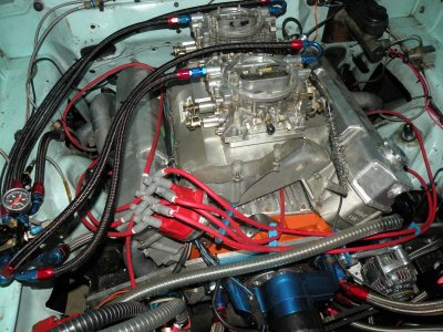

they are allowing tunnelrams now from what i have seen and heard. my 1st picture is a inline setup and the last photo is a offset crossram with not alot of cubic inches.

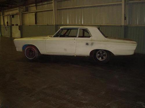

Hilarious :) Here's a pic of my NSS to be (just gettin started). Shooting for FX classes...
