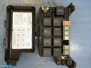

I discovered when I did a rehash, and eliminated the ammeter circuit problems, that a good way to go is a modern style relay / fuse box under the hood. You can buy them (Bussman makes em) This gives you a second fuse panel / relay box to run the heavy loads, like fans, headlights, and pump, with one for maybe? alarm? and one or two for charging and ignition. That way not everything is pulled off of one supply line going INTO the interior of the car.
What this does, then, is relieve some of the strain on the supply line going into the interior of the car, with some of the heavy loads being supplied from the starter relay, through the engine bay relay/ fuse panel, and shortens wiring length, etc. "Built in" improvements for headlights
I used a junker relay/ fuse panel out of a Voyager
