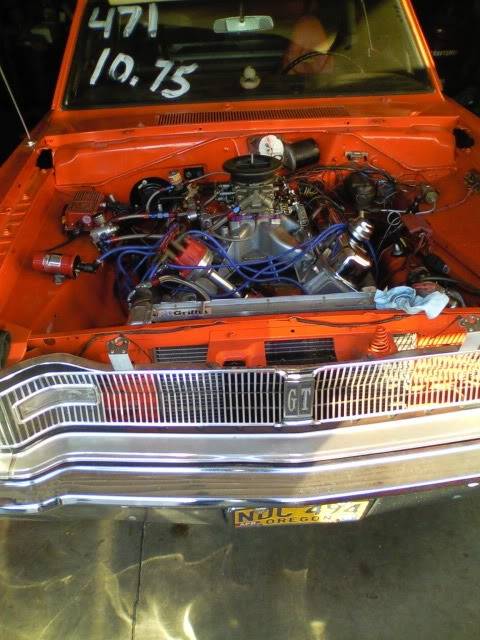

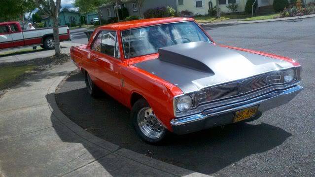

My True street car.
67 Dart.
440 ci.
11.5-1 engine.
Eddy heads
Stock flow on my bench.
in.-246 @.600
ex.-198@600
Cleaned up.
[email protected]
[email protected]
Piston .004 above the deck.
Cam-Hughs grind #htl6064bs .587 in .594 ex.
Installed @103.
tti's 2" headers with 3" ex to dump's before the axels.
Timing set @ 34 degree's total in by 2800 rpm's.
280 Pass's before taking the bottom end apart.
No broken rings or pistons.
After 100 pass's down the strip took the heads apart and the valves were gum'd up=carbon.
This was with Chevron 92 octane with techron.
Changed to Arco= cheap 92 octane and valves were clean when the heads were cleaned up this year.
Don't buy into the cr-p about Chevron gas keeping your engine clean.
I have about 5000 street miles on this engine and 280 pass's at the strip.

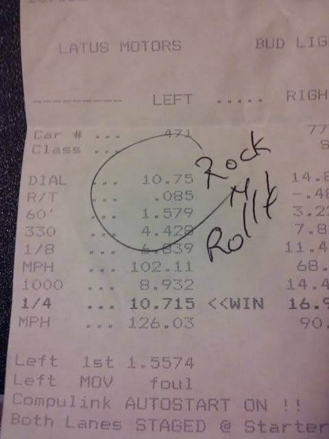

The car has run in the 10.70 range at the strip.
I guess I posted this more for the guys wanting to build a high comp. street engine.
For you guy already into detonation the answer is to solve the problem by changing you combo.
I know these are harsh words,
I'm ready for the remarks I'm going to get.
A quick fix is not the right fix,
I have a wall of shame for my mistakes.
Always buy the part for the build you are working on today.
Not for your next build.
