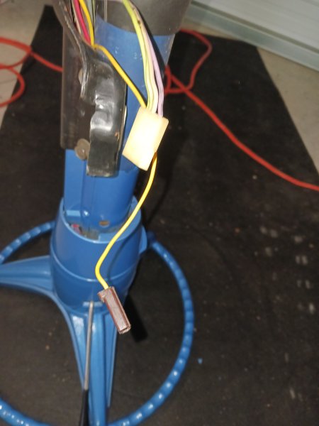

I pulled the column from my 71 roadrunner to install a steering box and rebuild the coupler, and discovered that I have some odd wires coming out of my column that I have not seen in my other 71s....... anybody know what these are for? The single yellow with a flat female connector and the 3 wire connection .......I have no idea what they're for?

You most likely have a C-Body turn signal switch. The 3 wire connector is for cornering lights. If everything else works just tape them or tie them out of the way.
Cool. I was worried that I might have jerked those loose from somewhere that I wasn't familiar with, but it did occur to me that I might have an alternate harness in there too.

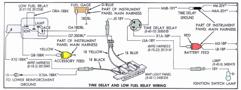

The single yellow wire is the key in courtesy light. It plugs to the time delay flasher system.
The three way plug as mentioned… cornering lights. On later years Mopar offered just this turning switch as a replacement for all bodies instead keep the production for each application
