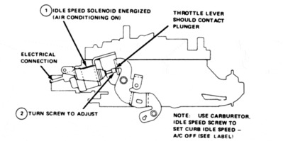

It's been awhile, does your throttle still have a "anti-stall" dashpot? A small solenoid in front of your throttle leaver on the side of your carb. Some are electric, some are vacuum operated. It's a fast idle control to keep you car from stalling during sudden stops. They can be adjusted or replaced if bad.
Just read that you have to check this yet. It use to be a common prob back in the day when I worked on these.
No anti stall dash pot or solenoid. Just the choke pull off dash pot. Don't even know what they look like.... None I can find in the FSM either... Do you have a picture?
