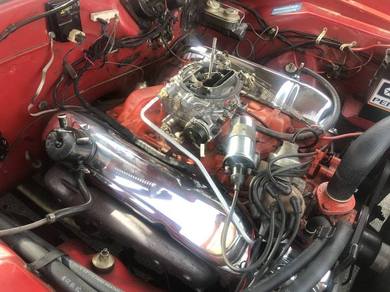

I added an oem style fuel line from Inline Tube replacing the rubber fuel hose to my edelbrock carb .I think it looks pretty good. I figured id share a picture
Safer too, the NHRA allows a maximum of 12” of non metallic or non-braided fuel line in the entire fuel system. Even if you’re not building a race car, it’s still a good general guideline when you’re putting a fuel system together.
The fitting on the carb to the fuel line, where did you get it? I just purchased the same inline tube setup and originally I had a rubber gas line hose hooked up to a barb fitting.
