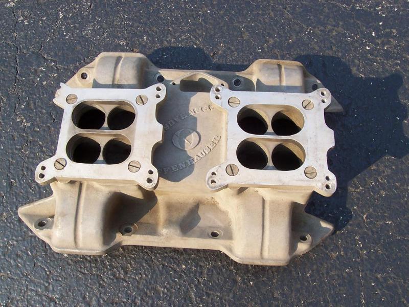

I found this intake looks good save for the broken plate. anyone know if a stock plate might work. Offy wants over 100 bucks for a plate if they have one in stock
yup it can be repaired
take it to a good welder he'll be able to make your repairs ,if done right you won't be able to notice the repair
Sweet old tunnel ram! Since the one looks like it's in good shape, it might be easier and cheaper to make a template of it and have a new plate CNC cut instead of trying to recreate the missing piece and tig weld it up.
you could weld enough on to machine a new ear or have new ones made. I had brackets made for my rear brakes pretty reasonable but those were out of steel and I provided them with the engineering drawing. Realistically you might be about the same price as buying the original replacement but worth getting priced out from a professional.
