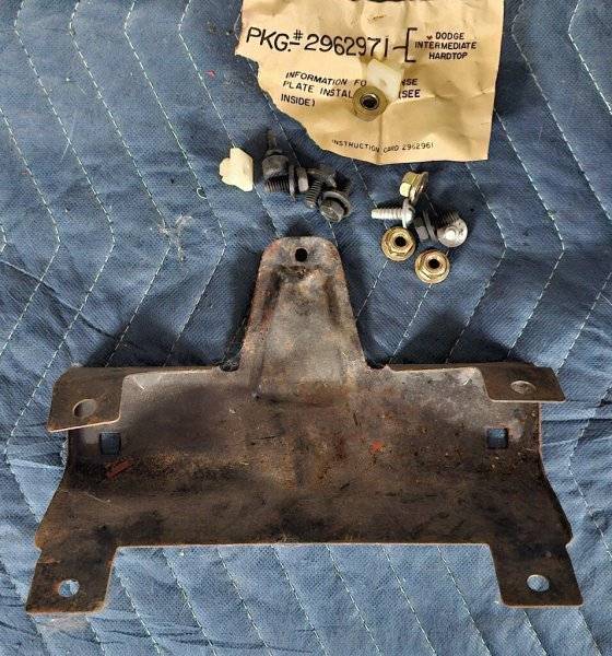

Rear bracket that the fold up license plate holder mounts too
This is what I mean
View attachment 1767168View attachment 1767169

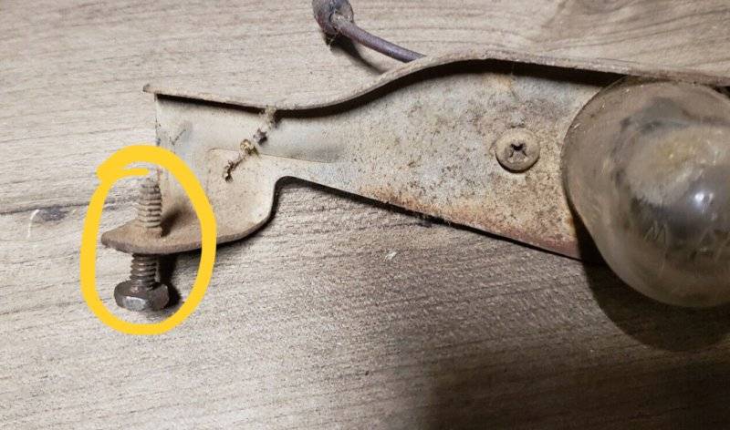

Did you tried with light assembly in place?
73/74s (or at least those 73/74 I have worked on) doesn’t have that extra surface on license bracket, so I can install without deal with the light.
The only difference is try to fit with or without light in place. That’s all.
I am not seeing how adding the light assembly first is going to allow the one I have fit
Backwards… first license plate bracket… then after that, the light… will overlap that extra surface on license bracket
I tried to put I on with the light bracket it off and the license plate bracket hangs past the bottom of the bumper
Tab provisions or bracket could be bent?
All what I can say is how is made the assembly. Now, dealing with used abused parts (or new bad repros) on a tight areas can be tricky. Hard to say from the distance

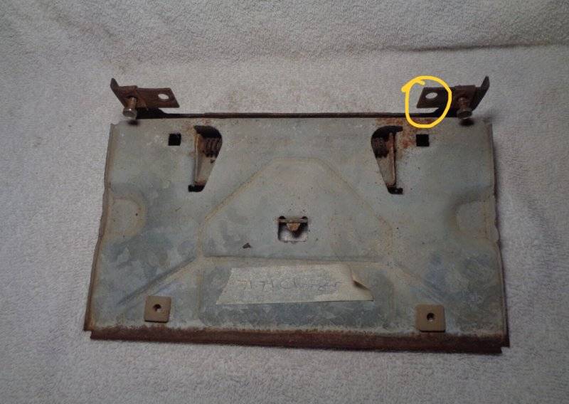

Is this what you need ?
BTW, the one you removed is exactly the same to the one you bought.
actually it is not. if you look closer you can see there are tab cut outs. similar but definitely not the same.

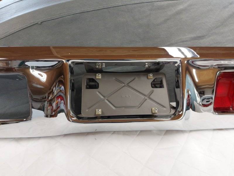

Here's the outer side with the plate holder in place.
And here it is on the car.

I might have one. PM me if your still needing one. Also 73-4 Charger is a little different than 71-2 Charger and Plymouth is different.
But I guess interchangeable anyway. I just can see the difference (for fitting at least) on the extended tab meeting with the light bracket assembly.
Correct me if I’m wrong please.
