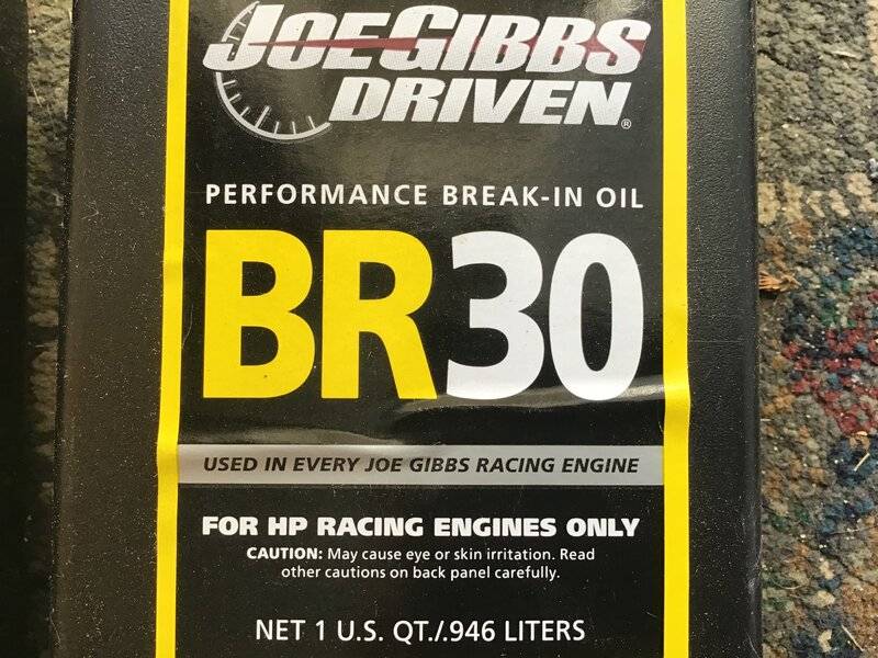

Use Driven (formally Joe Gibbs) Break-In oil, either BR30 (5W30) or BR (15W50). After the break-in, change the filter, and continue to use the break-in oil if you desire up to 400 miles or 30 days. If you want to change it right after break-in, that is fine too. After your finished with the break-in oil, use Driven products: HR1 (15W50), HR2 (10W30), or HR5 (10W40) as you desire. I would discourage synthetic use in a flat tappet cam engine as I have lost two to this I feel. Synthetic works better with roller cams, and a conventional works better for flat tappet cams. I would also highly discourage you to use regular oil with the zinc additive (ZDDP) as it would need to mix with the oil, and you would be doing break-in with unprotected oil. Also, the additive method is not as effective and had some drawbacks. Just stick with the pre-mixed "High Zinc" oils...
