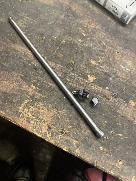

No mixed fluids and no leaks. I pulled the valve covers and found the #2 exhaust pushrod was loose and bent. Top of the adjuster screw was broken off which is weird. I found the broken end laying in the head (lucky!) the lock nut was not tight.

I tried to straighten the pushrod, but there’s only so much you can do.
I wanted to throw it back together to see how it sounds but the adjuster is too short for a lock nut.

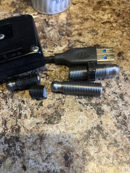

Sounds like an over torque on the adjuster nut. Have seen it quite a few times. Many blame the adjuster itself.

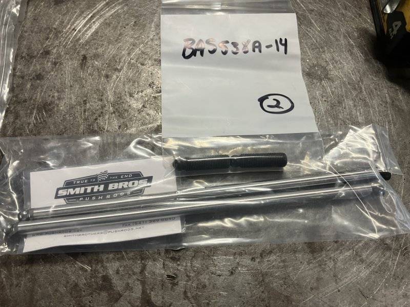

I ordered spare pushrods and adjusters from Smith Brothers today and I think they have shipped already. Nice!
In the meantime I made a new adjuster and straightened the pushrod.
I just got it back together and it sounds good.
How many threads do you have on top of the nut of the adjusters? That will show you where it broke
Smith Brothers came through quick with 2 custom length pushrods and 2 adjuster screws.
Top notch service!
