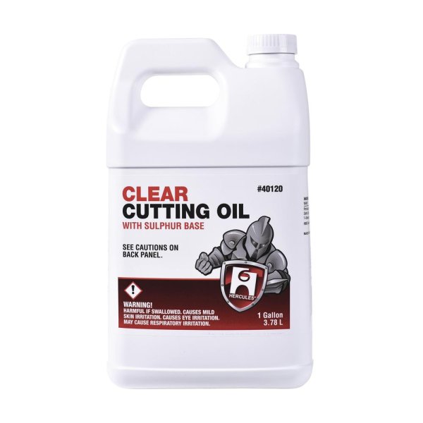

Use a sulfur based oil like pipe thread cutting oil. You can usually get it at Menards or a plumbing supply house.
You need to flood the bore so the stones don't pick up metal ad put deep scratches in the bore. The Idea is to
keep the stones clean and stroke the hone so the stones wear evenly and give you a straight bore. Use a 220
grit stone for finishing!
