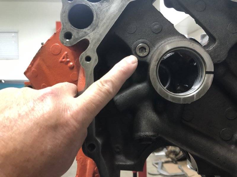

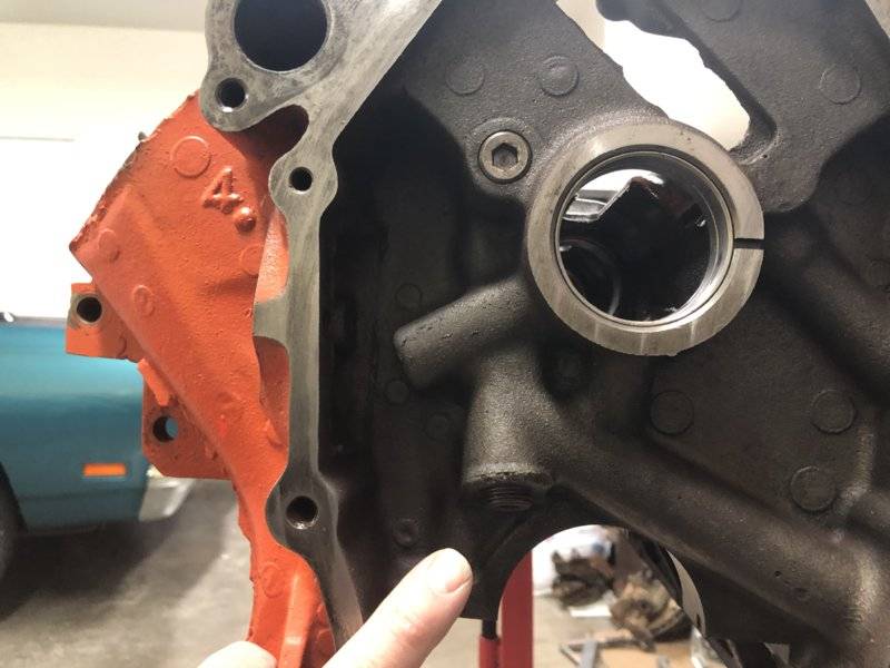

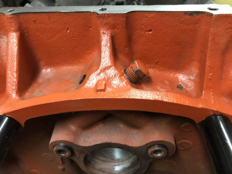

View attachment 878023 View attachment 878024 View attachment 878025
The one in the first picture is the one i missed putting in and it cost me a new set of bearings... They weren't bad but installed all new just to be safe.. Make sure that one is IN THE BLOCK. Otherwise your oil just pumps right past the cam and right back into your pan. Just glad I found the issue when it was on the run stand. Did run the engine for 4 or 5 minutes... "thought i had oil pressure". Also glad I had all of the rotating parts lubed up with liberal amounts of assembly lube. I think it saved my crank for being galled.

OK, I believe post #6 shows them all. Two around the front cam bearing(photo 1&2), four at the back of the block(2 in the bellhousing area, 2 outside on top, oil pressure sensor area, photo 3).

Ya, me too at first. But to diesel, those pics tell the tale.
