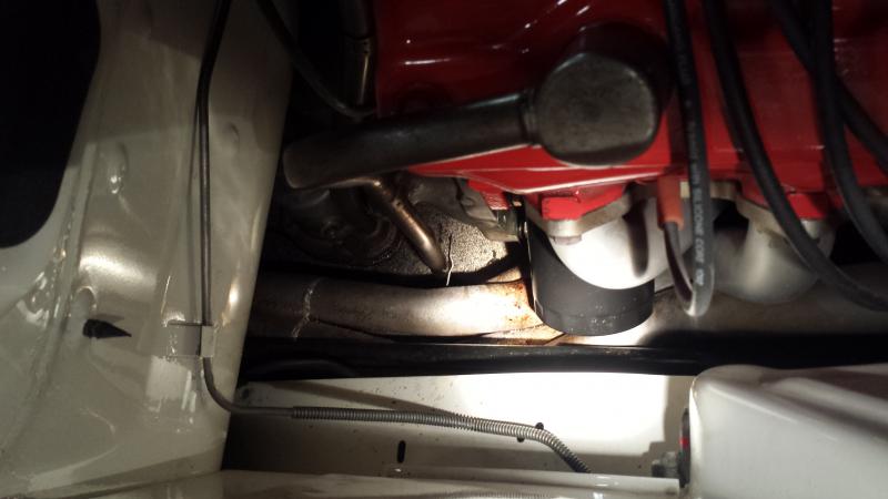

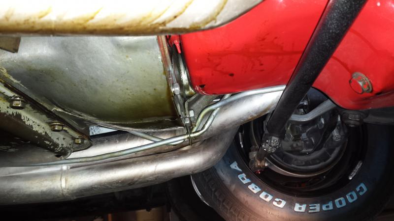

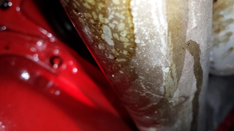

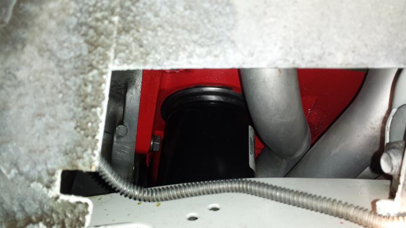

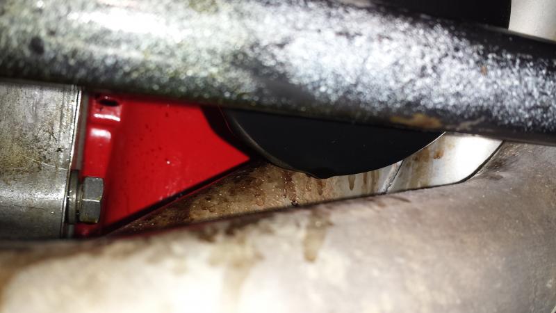

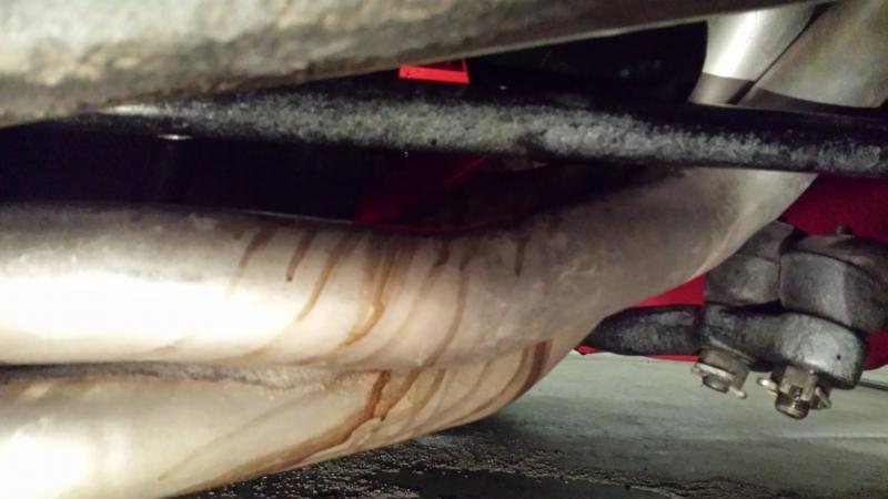

Here are some pics. Too hot still to start messing with but you get the gist. Again, 5k on the motor without oil leakage issue until today. I am hoping it is the adapter gasket for the oil filter. There is a good drip hanging off the filter so it probably came from above and the oil pan behind the filter is drippy with oil. If the rear main was leaking I don't see how it could get splashed up near the oil filter. Pressure switch is still bone dry, not coming from there.

Now after the engine cools off,run your fingers across the back of the intake and along the back of the valve cover. You need to figure out where it's leaking.
Now that I see the pic's,,,,,,,you need to look under the valve cover and see if it is running down the block.If everything is oil soaked,you need to degrease under there and go for a short blast at WOT and get back to the garage to see where it's leaking.

I wiped everything down the last time and everything was coated so it didn't really help me. One item of note: the oil pan and bolts behind the filter were dripping with darker oil like it was dirty. I don't know much about the filters but could this mean filter/gasket leak?

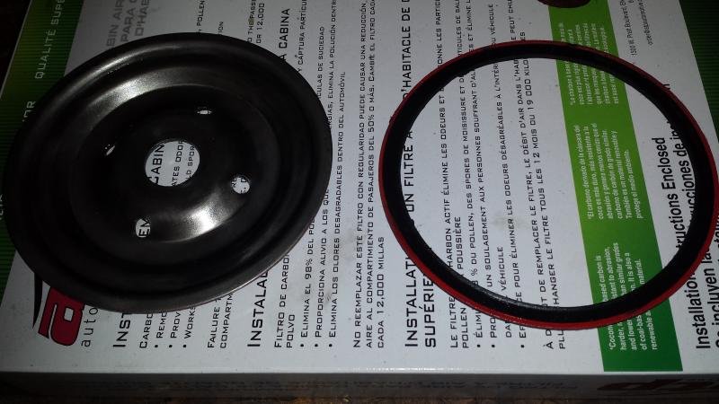

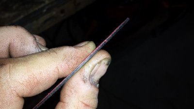

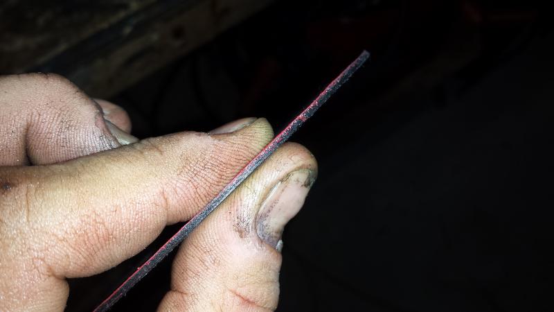

Here are pics of the adapter and gasket, didn't look bad. Plate is flat. Gasket is not what I expected, kind of a hard material. Not rubber. It is .065" thick. While it is out, should I drill extra holes in the plate to aid in flow? If I am getting higher pressure at upper rpm could extra hole alleviate the problem of blowing by the gasket (if that is the source of the leak)? Anyone have a part number for replacement gasket?
Oil filter gasket judging by the spray pattern. That is very close to the header tube and will get very hot, may warp and fail. Could try a more pliable gasket material and wrap the header at that spot to control the heat.

I am waiting until noon to pick up my new gasket from Autozone, Felpro # 70522. They are good at getting in special order parts fast. I have my pass side v cover rigged to accept a pcv valve. Used a brake cylinder grommet, looks like a baby bottle nipple lol but looks like it could be stock.
One thing I did observe....the adapter plate when in place without the gasket hit the center nub while the outer edge floated. I cannot believe this would be good at sealing so I used a large socket on my shop press and pressed the center in a bit. Now the outside ring contacts before the center. Should help.
