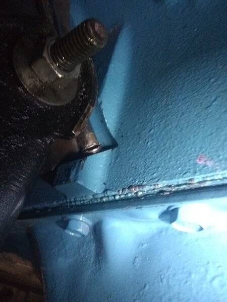

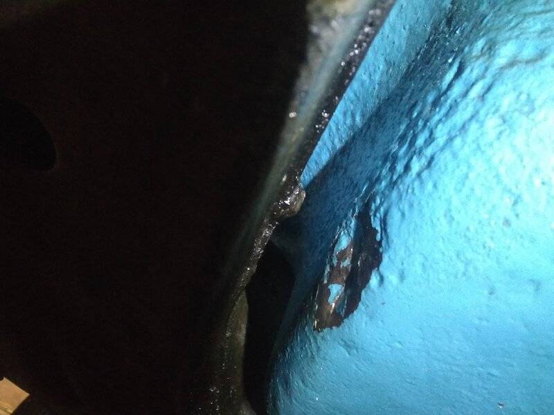

At first I found a dent in the front of the pan sump, cause by a matching blob of weld on the k member. I must have dinged it when installing the engine. The pan is original, and is pitted out side, so I figured really thin there. It was definitely leaking here, but not enough to explain the qty. Time to install the Miladon pan I bought awhile back to solve the sloshing issue.
Not feeling good about having found the problem, I looked through the oil leak threads here, and was getting ready to try to pressurize the crankcase. I was really looking over the bottom, and and saw the the dipstick tube is cracked just above the block. That explains things a lot better, but of course it will be a much tougher repair.

Seems weird that an oil pan can rust through, but I have changed several over the years, on different makes of cars.
Just part of being in the rust belt.
I picked up the engine used in 84 and the pan was on it then. Engine was siezed , probably sitting on the ground.

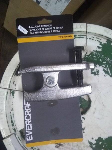

Got the drag link down today, used the tool pictured and it worked great. I also ground off the offending weld splatter.
