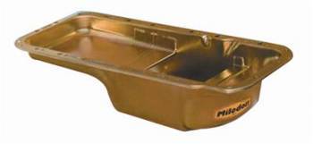

Milodon also has a road race pan with a depth of 5.5”. Is that the ultimate better way to go?

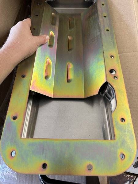

In any case, a windage tray or scraper is a good idea.

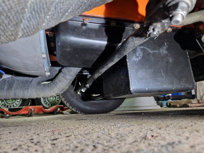

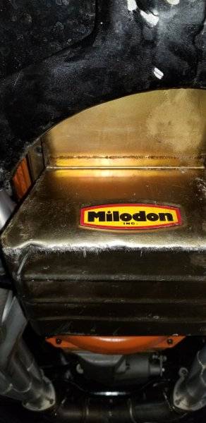

I've run the deep 8-quart Milodon pan on several BBs - in early Bs, '68 RR, & A-bodies - and never hit them on anything. Most of those cars sit/sat at stock or lower front height.
I don't like drain plugs at the bottom face, though: saw a guy clean one off on a bump and it drained the pan almost immediately.

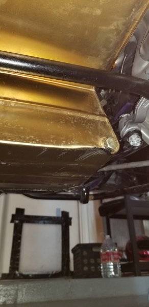

I am running the Milodon road/race pan on my Bee. Had to put a dent in it to clear the steering linkage on one corner. Also one of the factory welds leaked. Had to remove it and send it back to them. They rewelded and recoated it in their gold finish.

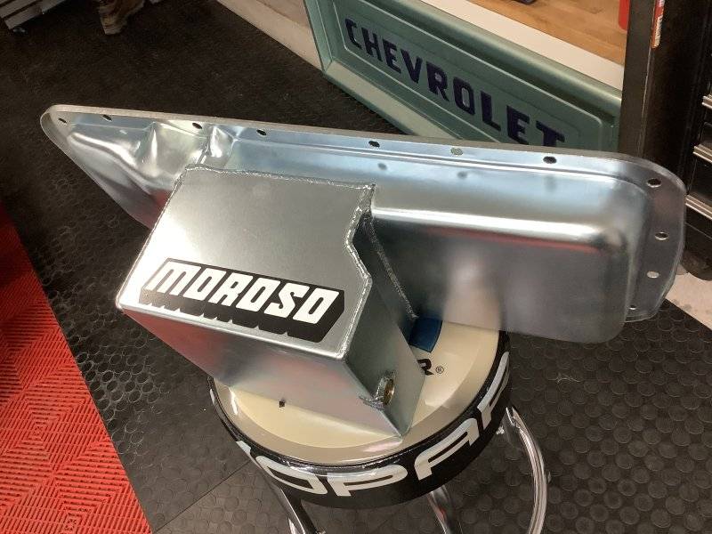

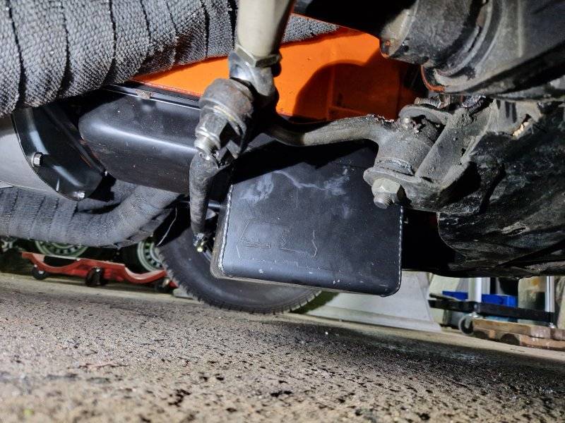

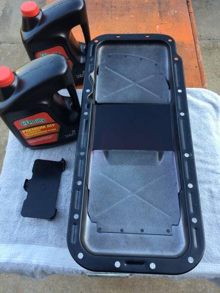

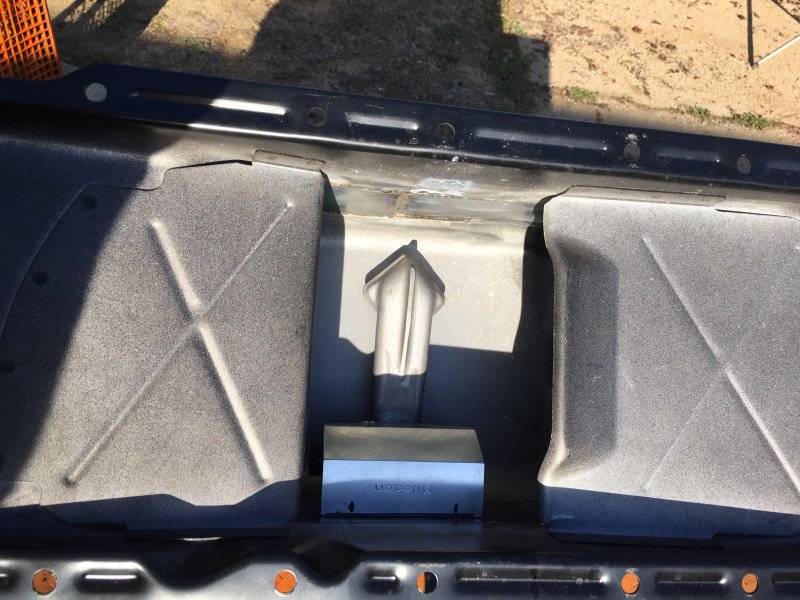

Moroso 20760 7 quart deep sump, this winter it replaced the decades old version that wasn’t notched for center link clearance. I’m pretty sure they are the same part number.
Wish i had this version of the Moroso pan. My pan is an old version, without the notch.
I just installed the other 440 for my 1970 RR, and learned that center link is hitting pan at full turn.
Will have to modify the pan or get a new one.

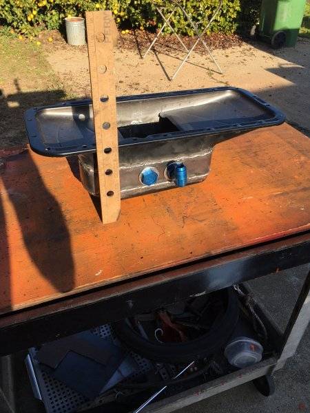

This happened yesterday. Had to take evasive action because of an inattentive driver in front of me. Hole is in back by drain plug. Luckly I was only about 1/2 mile from home. Lost oil pressure as I was pulling into garage. If I had a stock type pan I would have been ok. So I'm going with the 6 quart Mancinni or 440 source. Don't know if Mancinni is worth the extra money or not

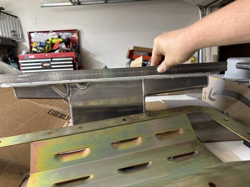

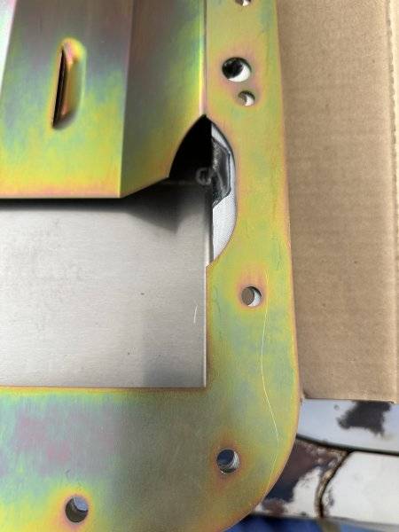

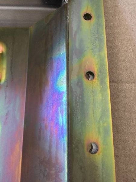

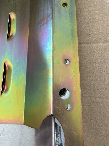

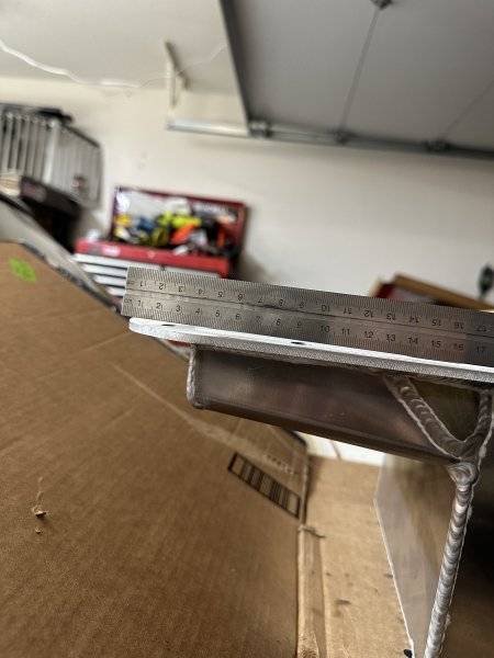

Well, I ordered the 8 qt fabricated aluminum pan from 440 source. I noticed initially that there was some slag from the weld near the drain plug. Basically the drain plug goes right against it. When I tried to mock it up, the holes didn’t seem to line up for the pan studs. I then noticed it doesn’t sit flat. The rail is warped, I’m sure from too much heat while welding.
I like the concept for sure. They say they test fit each pan prior to shipping, but this seems a bit too far off for me. I did reach out and they are willing to take a return for 100% store credit.
Try another or is it time for Milodon? It’s a bit more, but id assume they fit perfect.
By warped I mean 1/4” nearly, or 1/8” on each side with a high point in the center. Either way it’s not flat.
Milodon is best, the deep pan with kickouts is solid I run that on the street. Frank must have hit the milodon very hard in one spot to get it to dent that badly mine just has a few scratches from the road. The road race pan looks good though with the added ground clearance I would consider it for another build.
I use the Milodon street Hemi pan on my Savoy because it sits kinda low in the front. The Milodon 6 qt. pan has more baffles in it than the other pans from various vendors.
