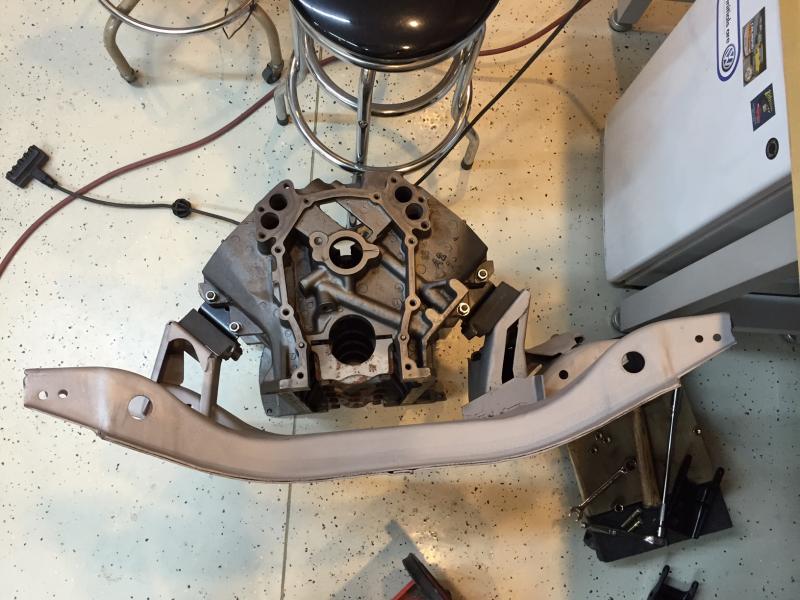

Which stock oil pan and pick up tube will work with this combo?
I acquired a deep Miloden pan with the block, but it might be too big and drag the street.

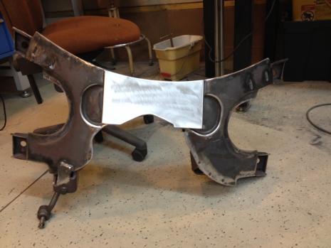

A pan for 413 will fit may have to grind a notch in the K member to clear the right front corner of pan.
You'll be a lot happier if you trim the k member 2" forward. Unless your sure the oil pan never has to come off in the car.

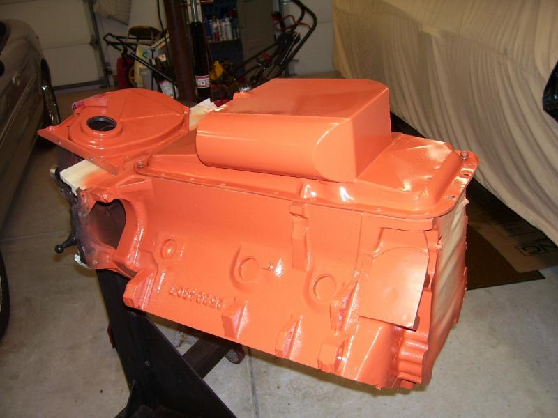

finding stock pans for the early b-bodies has become expensive and troublesome. i made my own pan; which was troublesome but cheap. the engine i'm putting together now will use the road race pan. fitting the road race pan, pick-up, and windage tray is little work.

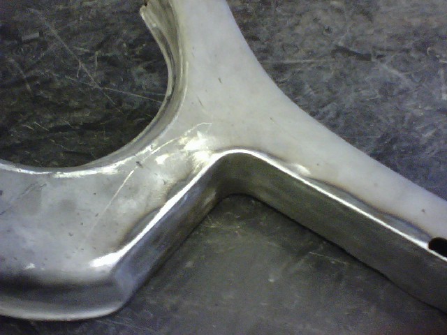

Doug, I've seen this done before...nice work btw. I'm curious how so much of the k frame can be removed without sacrificing it's strength or integrity.
That's why I box it. Works well on my 150 mph drag car, plenty of wheelies with no change in alignment.

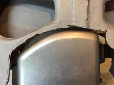

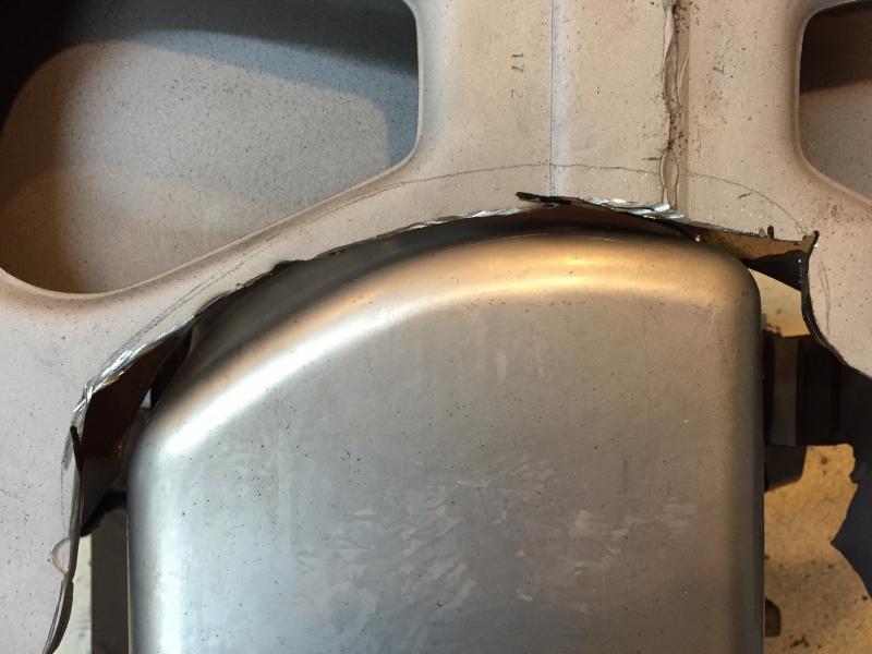

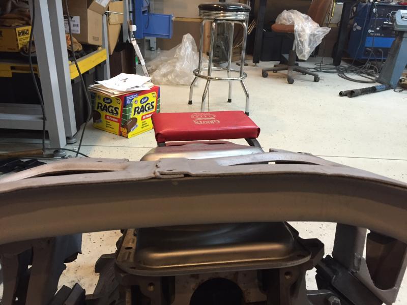

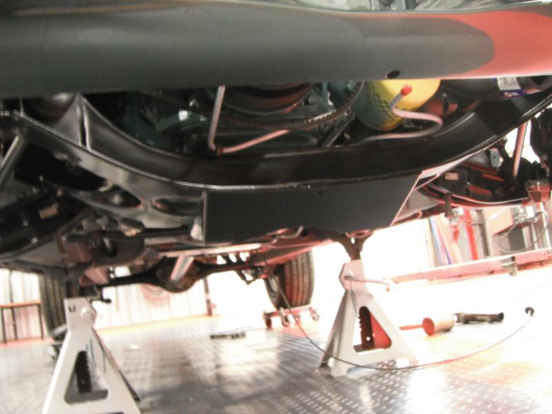

I am using a 66/69 Hemi oil pan had to modify my K frame. Can take the pan off with the engine in the car. Also made a 66 style skid plate looks "almost" factory.image (5).jpg005 (3).jpg
A couple of more pictures
Excellent advice and thanks for all the pictures. I have Milodon pan, but have no idea what # it is. Maybe there is a # stamped on it. I aquirred a couple stock style pans for mods if needed and I did get a BB K member with the car. Lots of option, thanks for all your responses!
