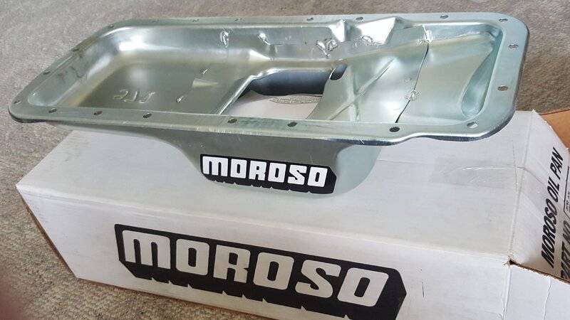

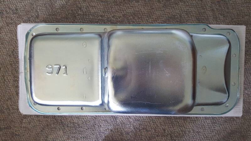

Once in awhile a Moroso pan shows up. It's a 971.
